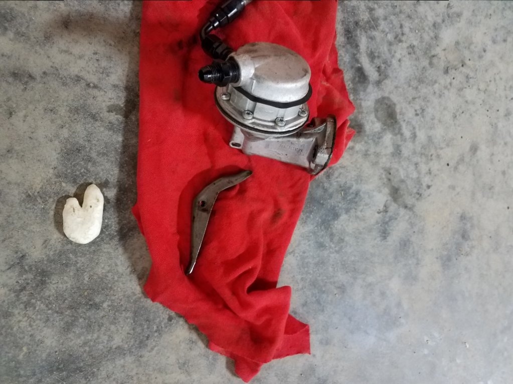

Just looking around for options after having an embarrassing weekend when yet another fuel pump took a crap in the mall parking lot! Originally when I built this car I installed a Holley mech fuel pump, it lasted 2 years before it would no longer keep up at higher rpm's so I tried a Carter which didn't even make it a year before it failed! This time it wore the pin hole egg shaped to were it just fell out so I'm done with these pumps which all appear to be made by the same manufacturer. My question is what options are there outside of going electric which I just may do?
never seen a pin hole go bad. seen a pump arm break but thought the installer was more to blame for that. i wonder if there's an issue with the pump lobe on the cam. may seem far fetched but a roller cam lobe may be a little different than cast cam. maybe rpm/pump pressure with a little extra lobe just beat the thing to death? those pump pins are in a blind hole with a pressed in plug on one end. did the plug pop out? maybe it's time to move away from a mechanical and go electric?

It's not a roller cam and the pushrod is the original but I did inspect it when I built the motor, looked nice like a healthy lifter. After I pulled the pump I did check it for smooth operation, felt as it should but I'm still going to pull the plug and remove it just to be sure.

What you see is how it came out except the pin was hanging partially out, enough that the lever was not attached anymore.

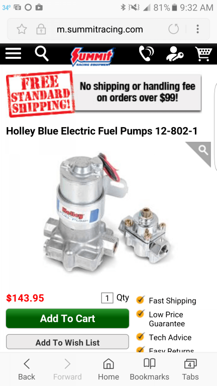

I'm thinking the same thing.. electric. Been thinking about it anyways to isolate the fuel lines away from the motor. I've never ran one so any tips on what to look for... stay away from? Summit has this kit that should do the trick but does Holley make a good one, are internal pumps better????
Correct me if I'm wrong but I'll just have to put a fitting in the bottom of the tank for the supply line and of coarse wire it up via a relay although it says it only pulls 3 amps?

If you do decide to go electric, you don't need the Holley blue, Unless you like adjusting the regulator. The red Holley is preset at 7 lbs and doesn't need a regulator. You will need a dedicated circuit with a relay and either ignition source or toggle (hidden makes a great theft deterrent). The only time I put a fitting on the tank was for my race cars, otherwise it will pull through original sending unit/lines. I ALWAYS put a filter before my pumps if you decide to go that way.

i've got a carter on one of my 440's and there's no telling how old it is. i'm thinking i bought it in the 80's and it's still pumping. the pressed in plug that holds the pump arm pin has had to fall out/wasn't there, tampered with or something. there's no other way for the pin to move unless the plug is gone.

As for the pin plug???? It was brand new and never tampered with. Makes me wonder if it was just a poor casting with porosity in the metal?
