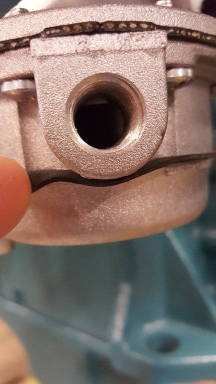

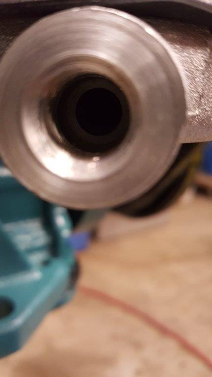

I bought a Carter M6903 fuel pump and I'm not sure how to plumb it properly. I believe it has 1/4" NPT threads. The inlet (at the bottom?) would likely just be a barbed fitting for the hose from the supply 5/16" fuel line, but what about the line to the carb? The outlet does not have anything to seat a flare onto if a hard line is connected and I didn't really want to use a hose there. Any ideas?
inlet
outlet
You'll have to get a fitting to accept the hard line there.

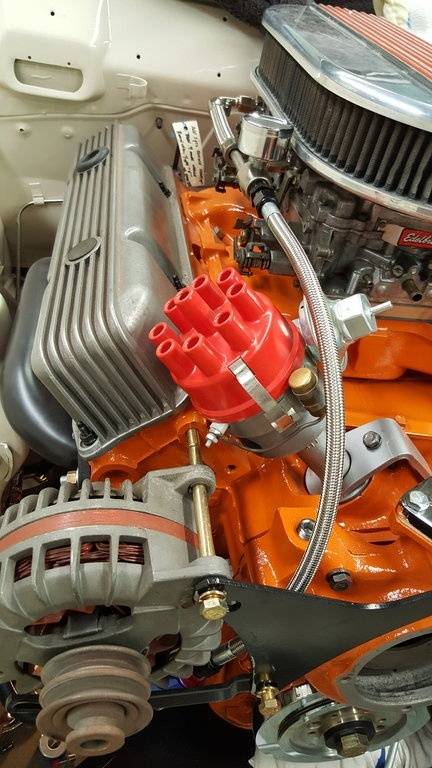

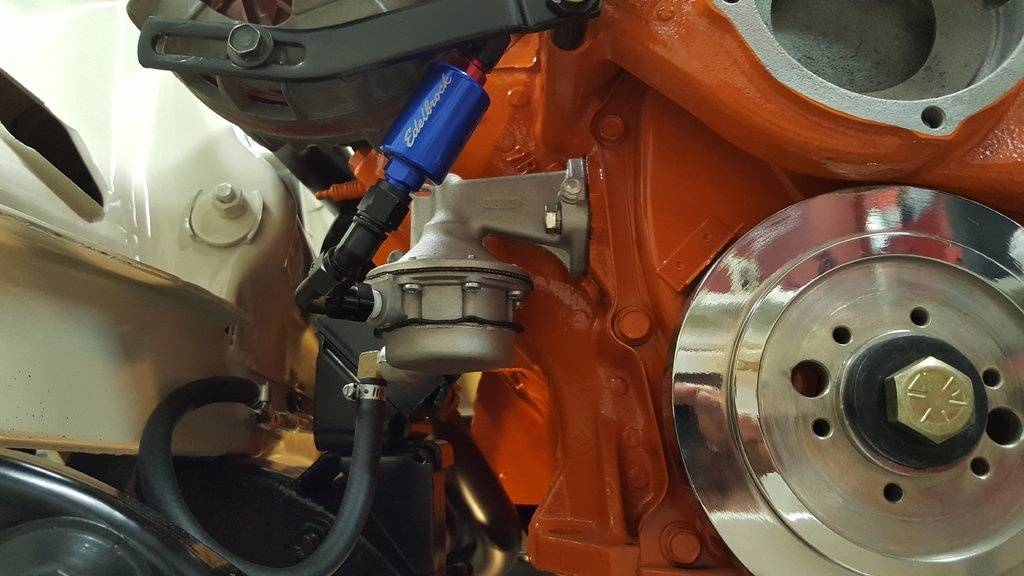

I used a 6an fitting arrangement with a braided hose and filter.
If you can find a male fitting with npt threads on one end and a female inverted flare on the other should work. The npt threads should seal at the pump. Oreillys auto and napa around here have a lot of fittings, otherwise just a barb fitting with a short section of rubber fuel injection line to attach to a metal line
Did you get any paperwork with the pump stating what thread size you have? My point is that make absolutely sure that it's 1/4 npt. My pump has 1/2-20 threads which aren't tapered, looks similar but not the same. I would say though that most pumps have tapered pipe threads.
No paperwork but i saw the specs on a few websites that say the threads are npt. I checked it with a few fittings i have kicking around.
After three stores, i could not find 1/4 npt to flare for 5/16 or 3/8. Pita! The search continues

Same pump, I needed a brass 90* fitting...found it at home depot. And used parts house already made steel lines, for all my to the carbs lines.
