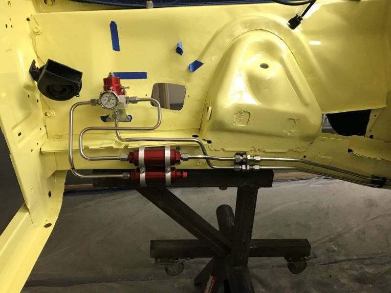

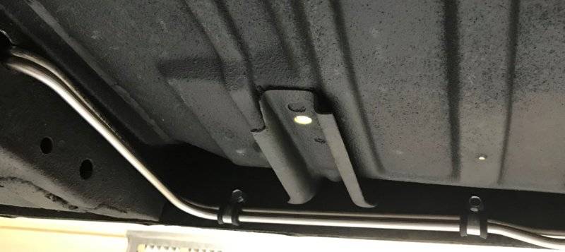

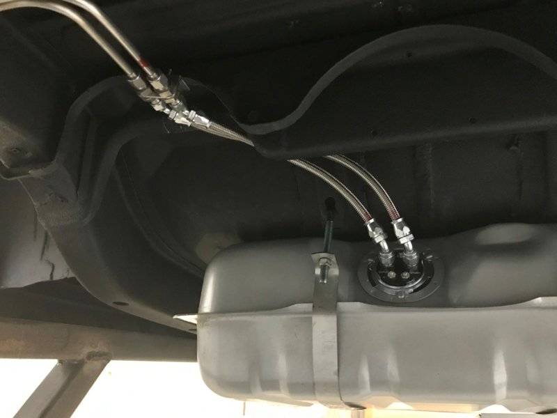

I located the filters and regulator up front so it would be a piece of cake to service. 3/8 pressure and return, SS hard lines and PTFE SS braided flex lines.

The regulator and gage are Aeromotive products. Filters are from Summit racing, 10 micron replaceable elements
The Spectra tank has a Walbro pump, I think 225 LPH or 59.43 GPH.
It could be a 255 lph, I would have to check the archives from when I got my fuel tank. Most of those pumps will go 90+ PSI, but the current draw really increases. Regulator will regulate pressure to that ever it is set at.
