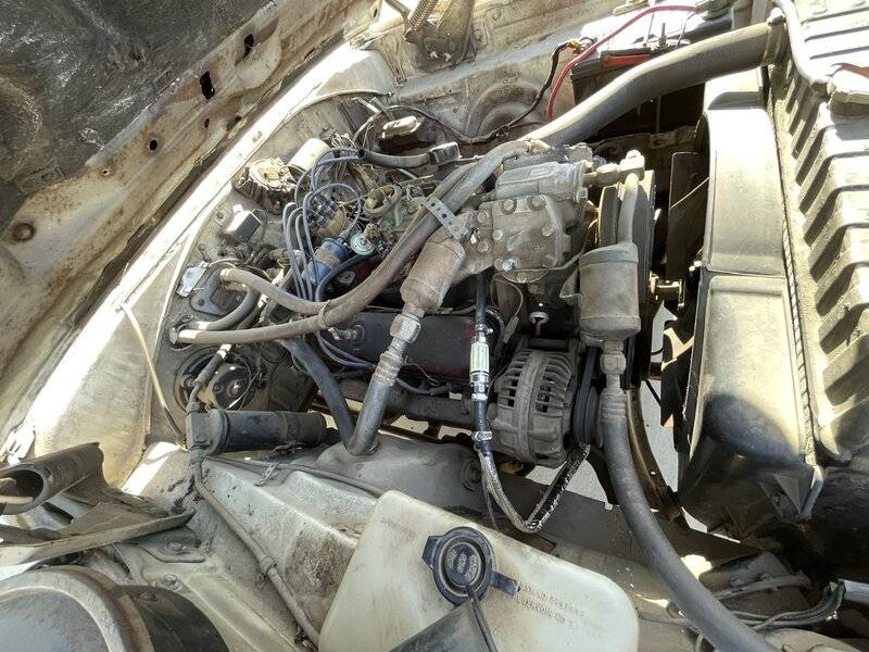

Currently the filter is installed horizontally, only notice the half filled filter after I run it hard and let it sit idle for a minute. Seems like it has hard time filling back up. Here is a pic of where the filter is located. Obviously this engine has seen better days. Slowly trying to clean it up.
You have a 318 2bbl, you don’t need a return line. Your problem will still be there. You need to focus to find the problem with your carb or fuel supply. The Fuel filters always have air in them, just cannot see through a metal one. That’s not the problem. All of our cars are dong that even when they run good.
And don’t be afraid, you’ll never get anywhere like that.
Take the gas line off at that filter and run into a container, have a helper start the car and see how much fuel is pumping out. Factory service manual says 1 quart in 1 minute or less @500 RPM. That will check the supply.
