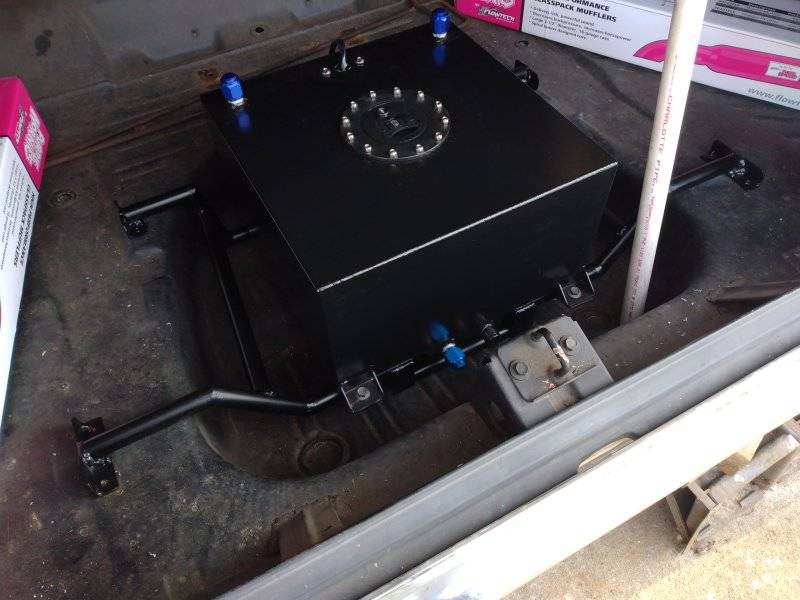

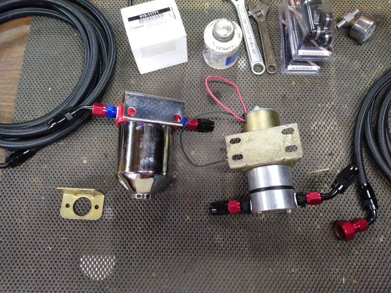

Getting ready to install the fuel system on my 66 cornet. 10 gal fuel cell in the trunk, cradled in the spare wheel well, fuel line through a grommetted hole to an elec. pump, to a filter, to the regulator up front. My question is for the pump and the filter, they will be mounted in the rear (behind the rear axle) on the P/S frame rail. The mount brackets for both are machined to accept 5/16" hardware, should I drill fully through both sides of the rail and run hardware all the way through, or is there a better way? Also, should I use any type of isolating material between the mount brackets and the frame, or am I over thinking this part?
OH, pay no attention to the poly-vinyl-chloride deck lid support device :lol:
Thanks for any input.

Mine is all mounted in the trunk. I have a backing plate the shape of the pump with the four bolt pattern bolted from underneath.
In the trunk is a better way to go. Way better if you need to work on anything at the track. No getting under the car. Just my 2 cents of course. ruffcut
Remember electric pumps are pushers not pullers. Need pump set where gravity can help keep it full. With gas tank in trunk, most tracks require a block off plate of some kind into cab of car.
isolating material needed. Helps with noise big time.
You need to buy a rivet nut kit and thread inserts. One of my favorite tools. You will find all kinds of uses for insert nuts.

That's what I was wondering about, if they will hold up to that type of situation. Never used one so I don't have any working experience. Thanks.
I have a one of them rivet nut kits and have rivet nuts all over different cars. They work great.

Picked up a kit and the pump is installed, filter's next. Thanks Mike :thumbsup:
