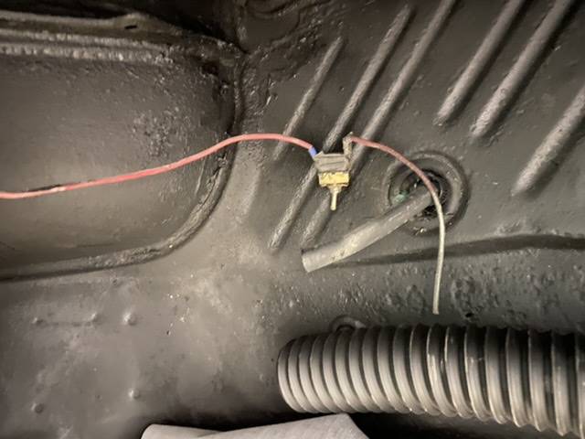

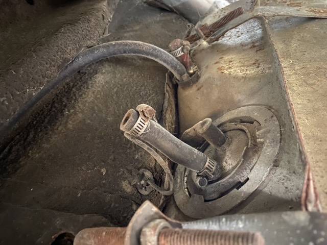

Attached are a couple pics. I want to be sure the lines go to the correct places.
so, does the fuel line from sending unit go to the fuel pump? I think yes, but figure I would ask to be sure.
what are the other fittings for? Vent lines? Where do they go?
what is this line for in trunk?
thanks!!!!

Yes, the tube coming out of the sending unit goes to the fuel pump
Any hose coming into the trunk is probably a vent (would go to a port that either goes back into the tank or outside) or a part of an evac system
