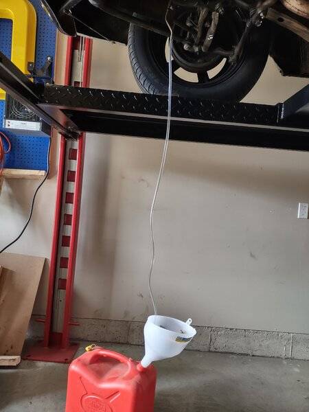

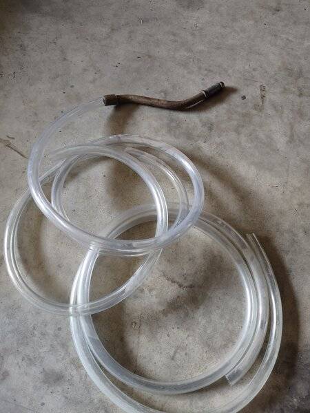

I am replacing the fuel tank on my 66 Charger. I assume all 66 or 67 cars are the same. I got the old one drained today. I tried to siphon from the fuel neck but no dice. I ended up rigging a hose and siphoning from the fuel line to the pump. Had about 9 gallons of gas left in it.

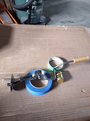

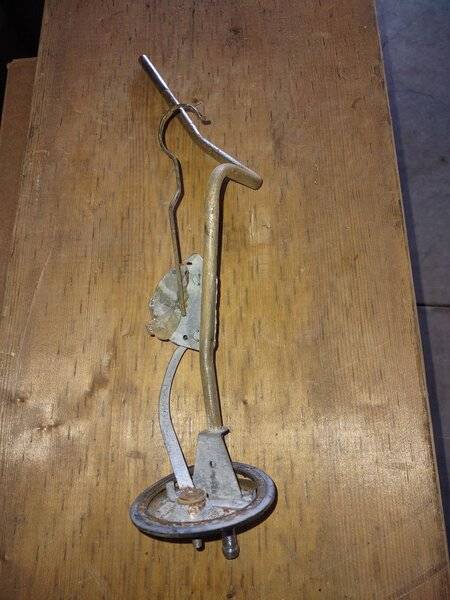

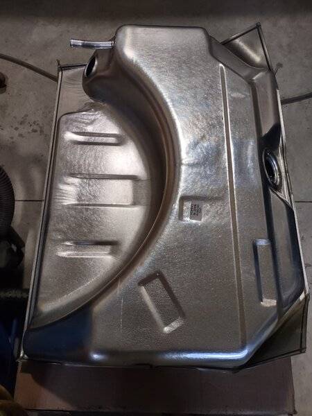

I heard stories of the sending units not being bent correctly to reach the bottom of the tank. I tweaked mine a little so the end of the sock is just touching the bottom of the tank. It goes in at about a 30 degree angle, so the sock is not parallel to the bottom of the tank. I also found that the float was not parallel to the pickup tube and it sat about a half inch high at its lower stop. I bent the arm so it is just shy of touching the pick up tube when sitting on the lower stop. Does this sound correct?
They are all the same, but some of the new ones have a different internal venting pipe, which can make it difficult to fill properly.

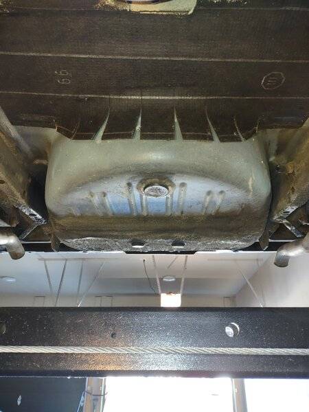

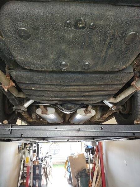

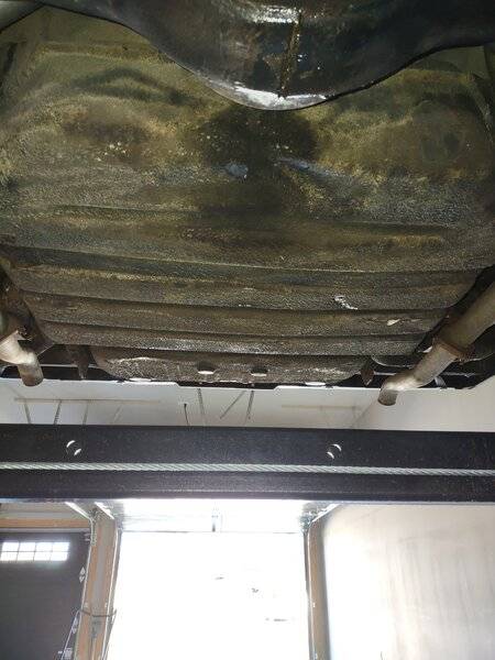

I worked on getting the gas tank out today. You can see the dent in the bottom, I figure someone crunched it with a floor jack.

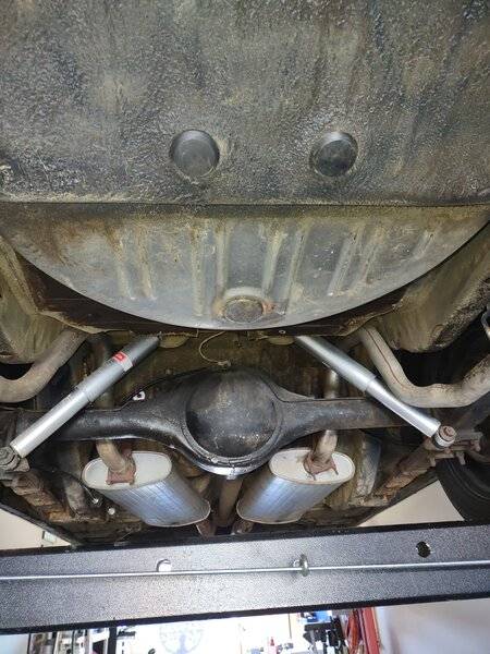

Tank came out. The felt pad stayed stuck to the floor. You can see to number 66 on it

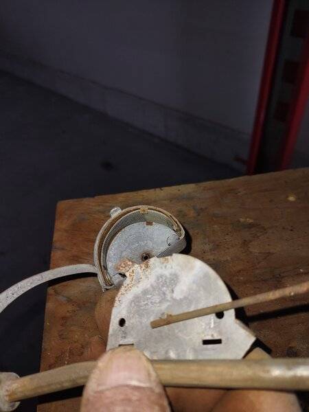

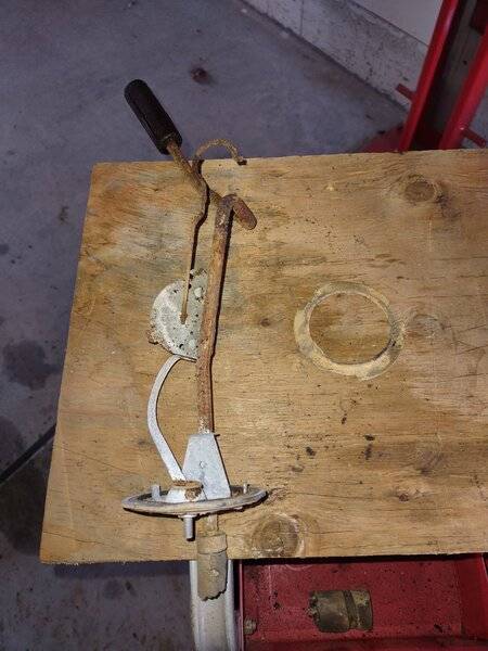

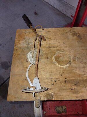

I figured out why my gas gauge didn't work. The float was missing. The sender cleaned up pretty well and the windings are in great shape. I will try and reuse it. I will pull the float off my new sender. I don't know if I can get the stainer off the new one and put it on the original sender?
