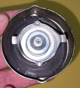

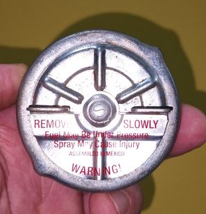

Hi, some pictures of my gas cap, I have a doubt if it is vented or not, I guess it is an original part, there is a spring inside, a small white plastic part that moves when I press it.

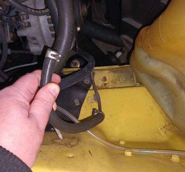

you can also see the air vent under the hood... ending like this...:BangHead:
...to be continued...
Looks like it's vented, but apparently it's not working

When there is a full tank, the vent pipe under the hood does not move.
When I removed some fuel, the vent pipe blows even engine stopped.
it is same with or without the gas cap.
now my question is probably stupid, but when fuel is sucked in it creates a vacuum, and that's pressure coming out of the vent line...how it works? :realcrazy:
