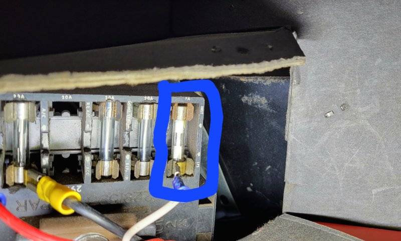

This is the dead circuit.
Forget the fuse. If you have high beam the power is there and the switch is good. You need to test at the dimmer switch for power going out low beam. If there is low beam power follow the wire to the bulkhead inside of car. If ok then check on the engine side of the bulkhead. If ok check at the left outer headlamp. You have to see something wrong. Also make sure the ground is good. Get this sorted out first then talk about the other issues. None of the other is related to the low beams not working.
It could be as simple as burned out headlights. The low beams have 2 separate filaments for low and hi beam.
And the burned out headlamps could be from overcharging. Seen it more than once.
I pulled the headlight harness off of the bulkhead and ran a jumper from the battery to the low beam wire and the lights work. Still checking.
The headlights are now working. I still can't find why the fuse circuit doesn't have power, any ideas on where to start?
If you read the writing on the block it says inst lps. Lighting for the instrument panel. Try checking for power with the lights on.
Looks like too big of a fuse in there, likely should be around a 3 amp
I will check on that again. You are correct on the fuse. The old fuse was blown and I stuck that in to test continuity.
Looks like it might be 7 amp. That fuse is powered this way. Headlight switch has to be on. Tail light fuse has to be good, power then goes to the clusters dimmer switch.
Now that the headlights are working, the circuit is hot again. Now to change out the fuse.
Thanks for the help!
Don
Don
Actually the low beam issue had nothing to do with it. The headlamp switch is divided. Headlamps on one set of contacts and power is fed directly from the fuse link circuit to the switch. The tail lights are on another set of headlamp switch contacts. These are fused. Sounds to me like you have a old compromised harness. Your fuse holders also look like they are corroded.
