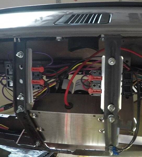

I just picked up a ron francis xp777 wiring kit. I was wondering where everyone has mounted there fuse panels?
Removed glove box liner, and installed where glove box would have been.
I'll look for pictures
I found the images on my GoPro Hero5, but the GoPro Quick editor keeps "not responding".
A description; Looking to the front, like sitting in the passenger seat, the left side of the panel is attached to the dash support that has the support hook piece that the back of the radio bolts to. Another brace was added to support the right side of the fuse block.
This means the main constant power feed enter the top of the panel with the "flasher" at the top. The Majority of the connections will be at the bottom of the fuse block. Note: Be careful installing the fuses if the battery is connected. I accidently touch the metal case when inserting a fuse, and blew that fuse. I think it may have been one of the select-a-circuit fuses.
Got a photo from the back, found an editor. Ignore the dual spst relays mounted on the supports above the fuse block.
