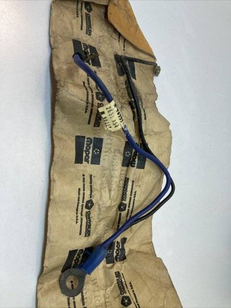

Anyone know what the difference is between OE part number 2631454 versus 2770412 which per the book is hemi car.
In pics the sure look the same except maybe wire color
2631454 shown ( non hemi ) trying to figure out the difference between the 2 pt numbers

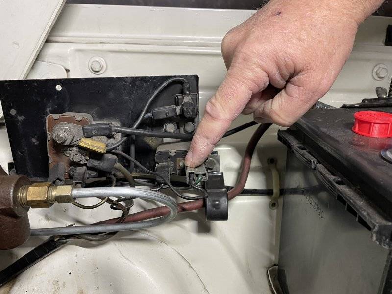

This is the one on my car. Which is fine. Just thinking might be a good piece to pick up as a spare for the shelf.
Again, I dont not know with 100% certainty if its the original or n8ot
Im not worried about wire color . Just want to be sure if it will safely work due to smaller gauge wire or something

I’ve got a 16 ga, blue tag one on my 66 too, and I know it’s a replacement. I couldn’t see anything immediately in the 66 Hemi supplement or 67 FSM that describes it. May have to dig further down in the schematic labeling.
What color is the molded tab ?
Yellow.

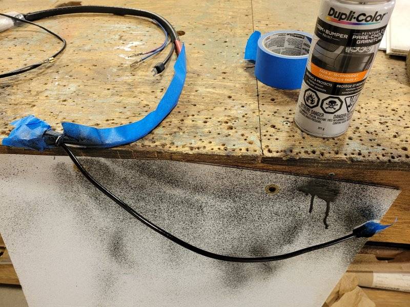

Note that your positive wire from battery to the starter relay is a replacement, being Red, as it should be Black as we determined a few months ago from survivor cars. I painted my overpriced reproduction that I still need to install..

Maybe. When i get a spare $350 i have nothing else to spend it on.
