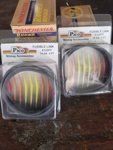

Currently working on a change over to a Toyota mini alt. Napa had some up to 12g and Summit had Pico 10g "8122pt"

Sorry, no 12 ga. I have 14 ga or 16 ga if you think it would work.

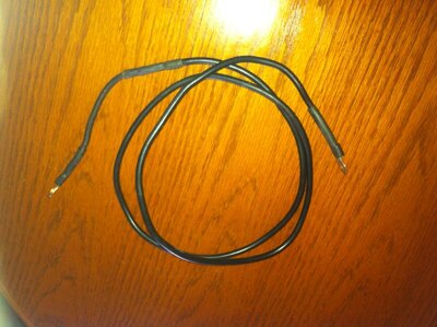

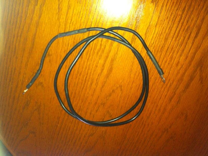

Don, I've been making these lines for friends for years now. I have the same type of wire setup on my cars. It takes some of the electrical load off the bulkhead connections. Here is one that I have, 8 gauge wire with a 12 gauge fusible link with the connectors. ($20).
Please do yourself a favor and don't use a larger fuse link that 14. If you have a short somewhere while the 12 gauge fuse link takes its time to blow, a bigger damage will happen.
Trust me when I say You don't need a larger wire than 10 gauge to charge the batt. An 8 wire upgrade will charge and feed the car, not just charge the batt. Except if you are feeding accesories from batt post, which in any case will be out of the fuse link protection, but will add more load to the line between the batt recharge process and feed those accesories and could justify the larger fuse link just to hold that.
