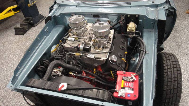

Just wanted to let you fellas know that some Dodge Dakota models used heater hoses with a molded in 90* on one end. 5/8" size so it might provide a cleaner appearance on your engine.
Mike
Yep you can barely see them at the back of the valve cover. Works great on the early cars that have the heater core on the
driver side.
