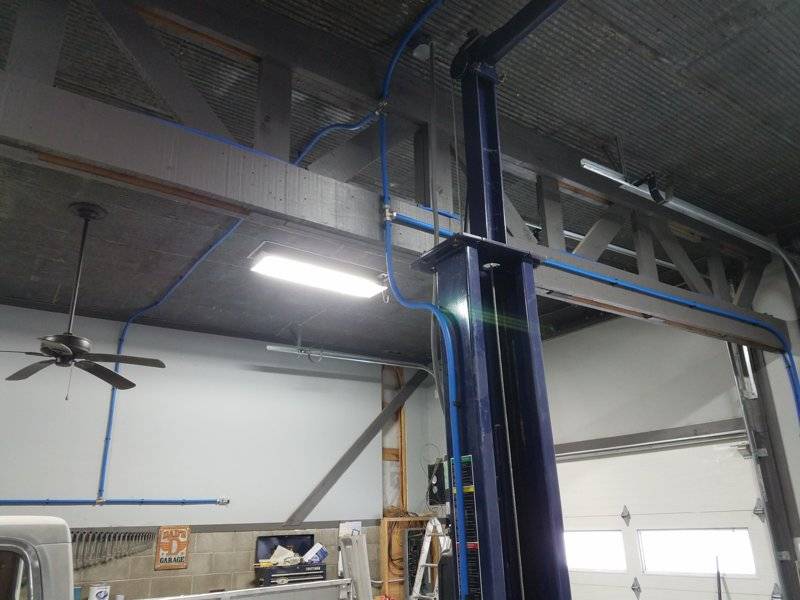

Picture from my other thread.... love this stuff!
