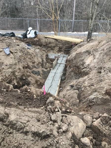

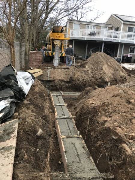

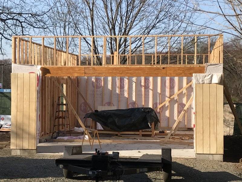

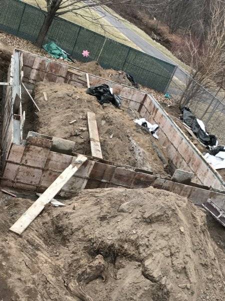

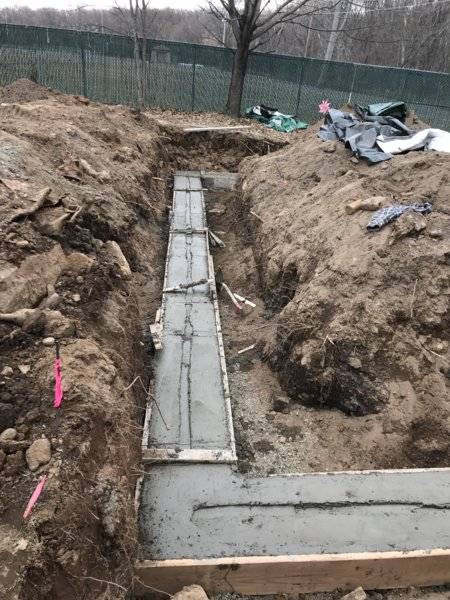

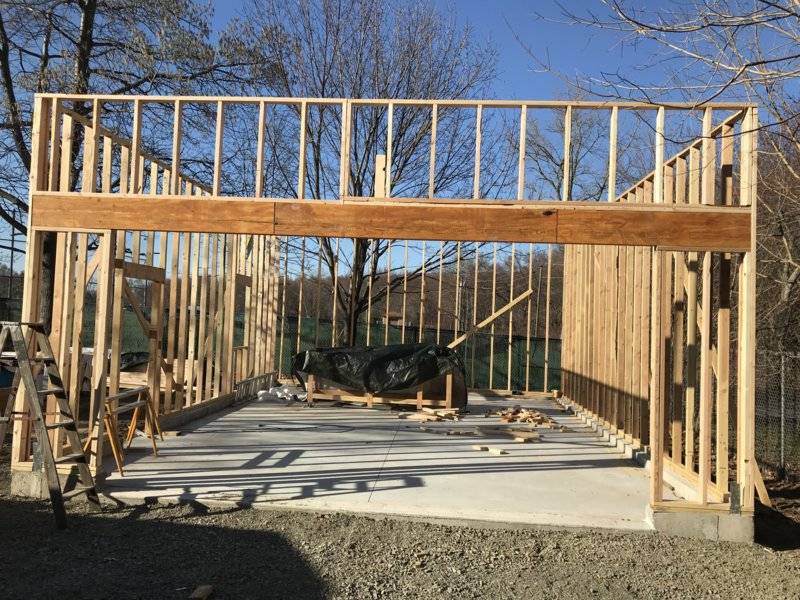

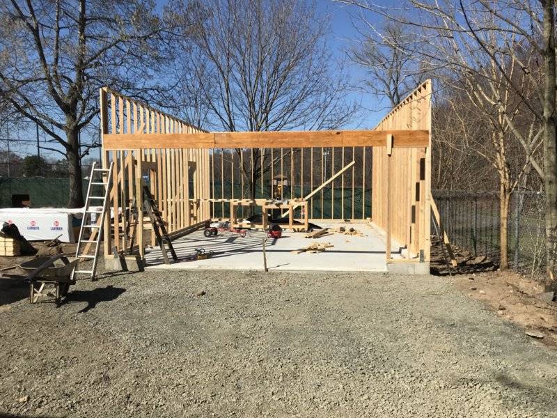

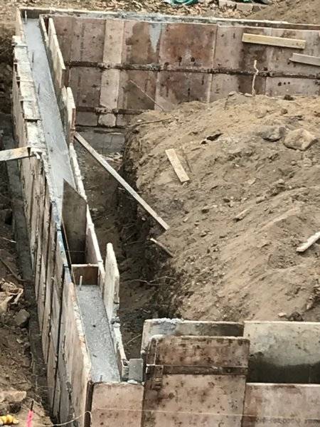

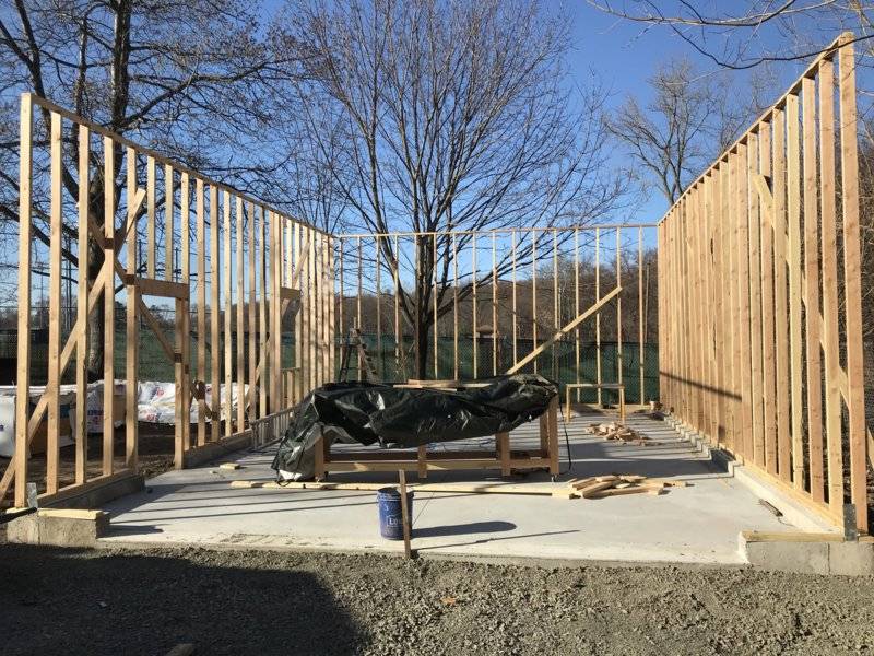

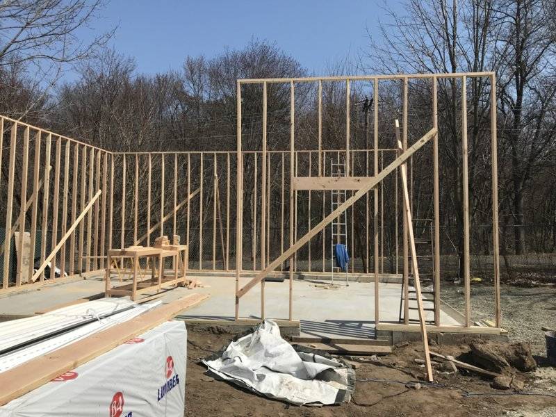

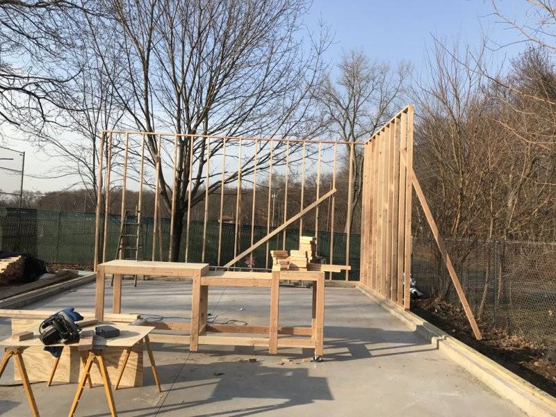

After many, many, many years of desiring to build a garage to house my cars, I finally jumped in to make it happen by the grace of God. It is a two car garage, with 12' high ceilings because I want to put a lift in it. I started the foundation in late March. I am using 2 X 4 construction with T-111 exterior. It will have a truss roof with a storage area. I will have one window, one door and one single 16' garage door.
IMG_1767[1].JPG IMG_1769[1].JPG IMG_1770[1].JPG IMG_1782[1].JPG IMG_1783[1].JPG

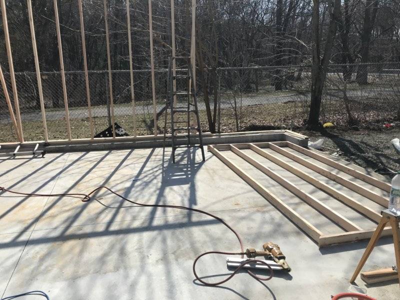

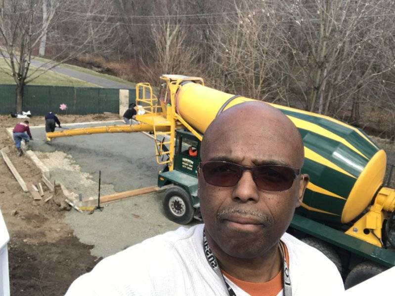

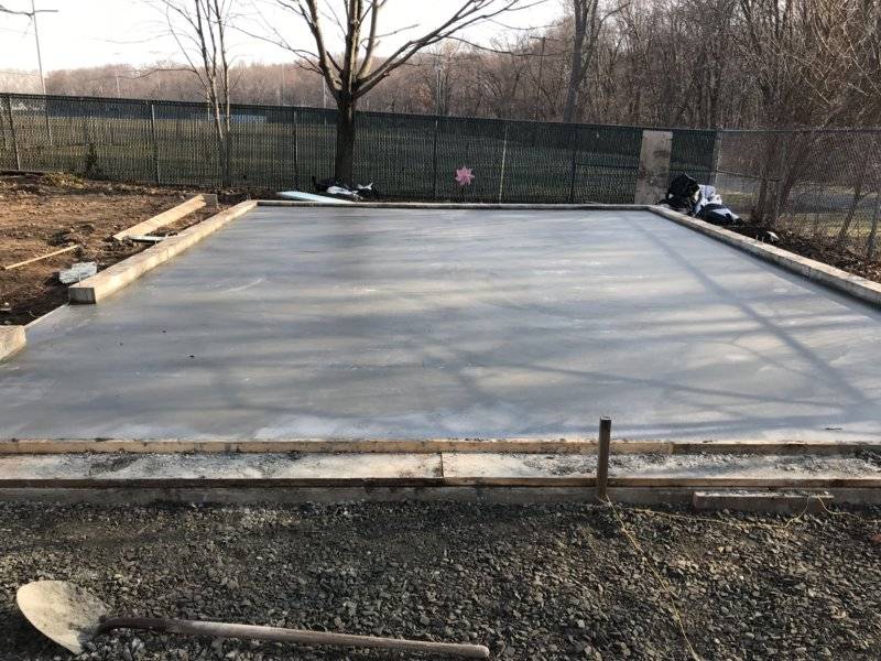

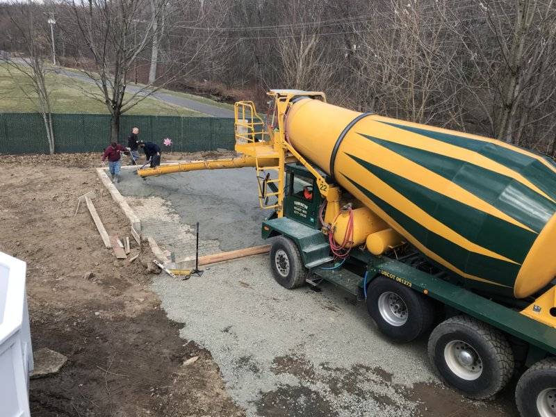

Then the floor went in. The lift called for 4" floors with a 3,000 lb. mix. I put in 5" floors with a 4,000 lb. mix.

Nice... I shall be living vicariously through you for the next few moments and drooling on my keyboard! lol

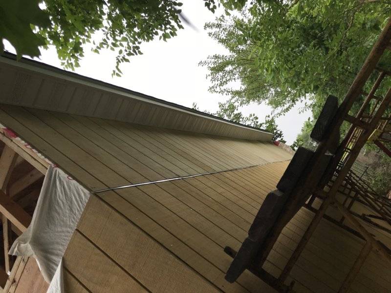

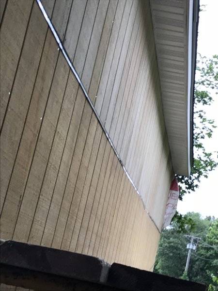

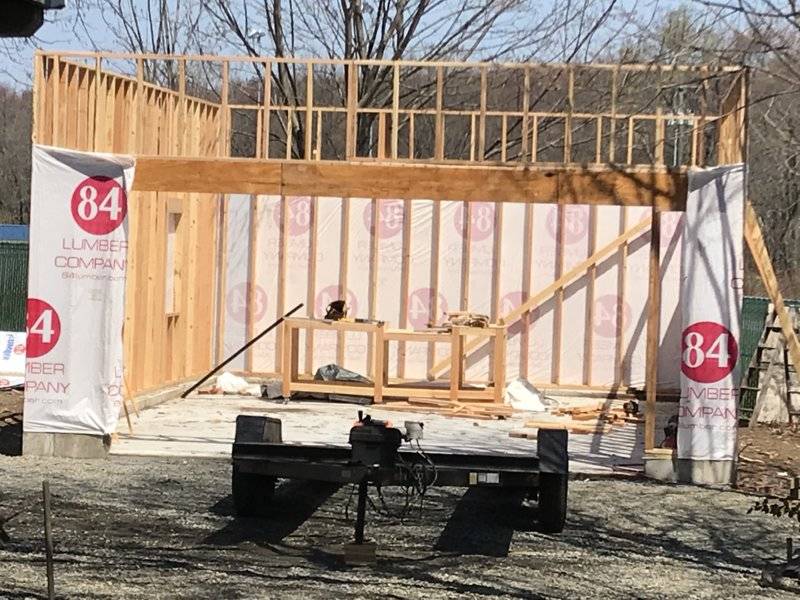

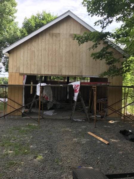

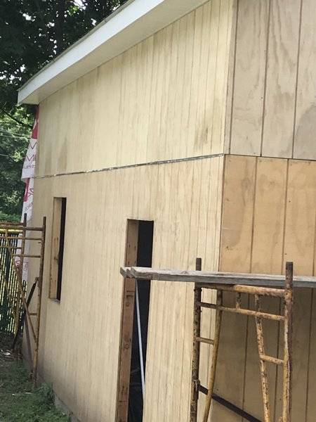

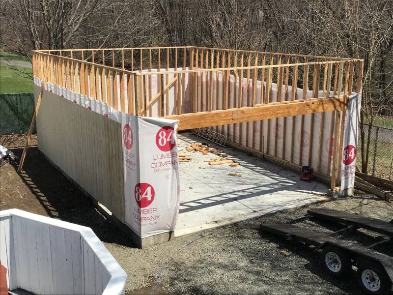

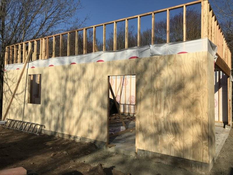

Work kept getting in the way of my progress. (Hahaha) Then in the northeast it kept raining on days I was available to work on it. Next fabric barrier and siding.

Looks great! ....but only a 2 car garage:poke:.....:D

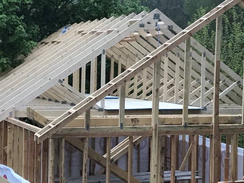

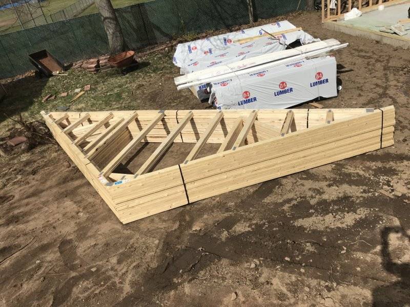

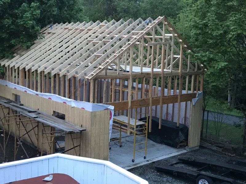

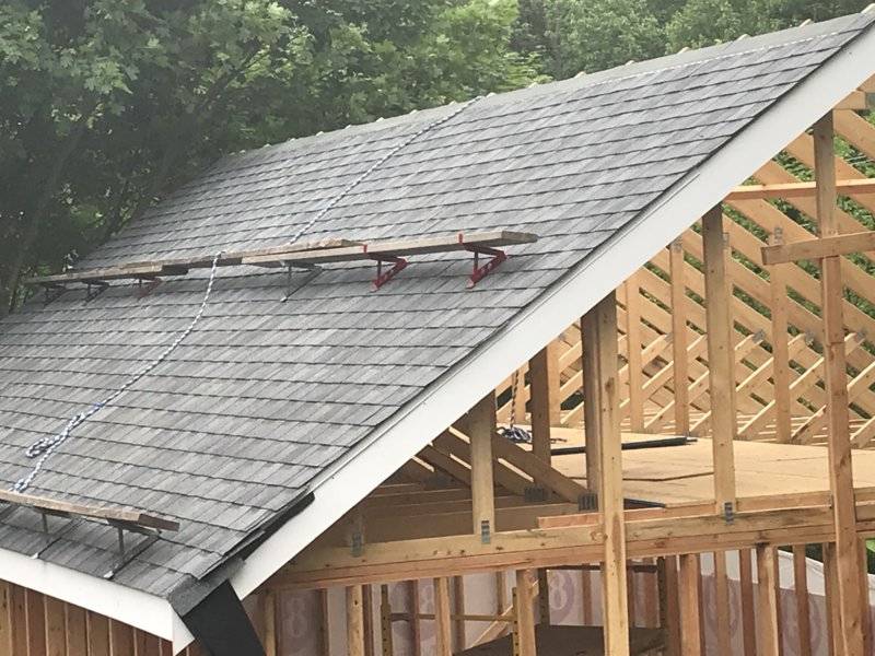

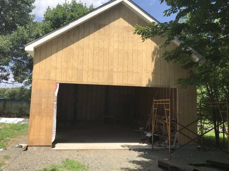

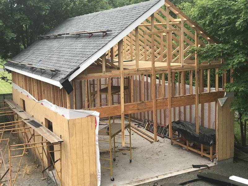

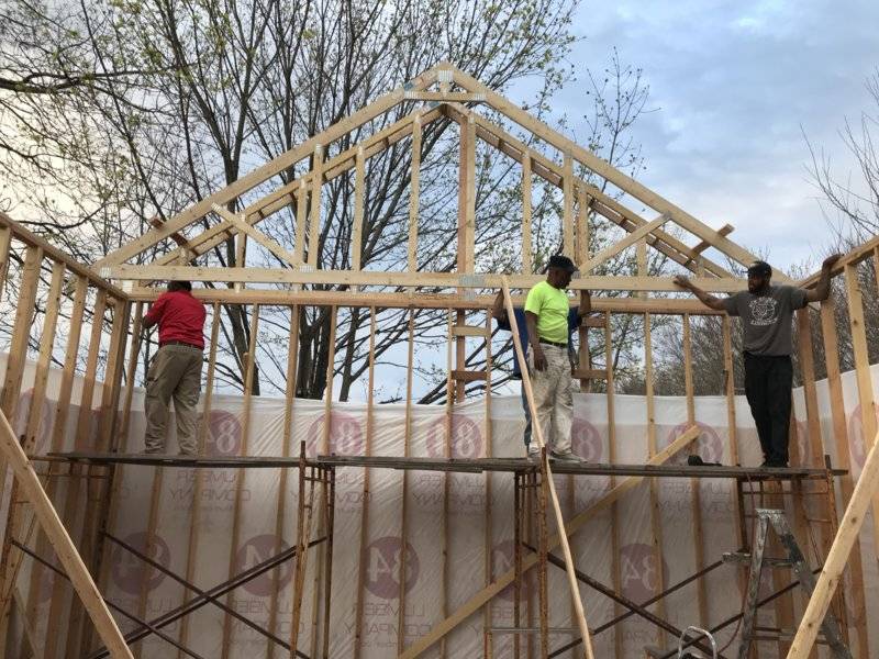

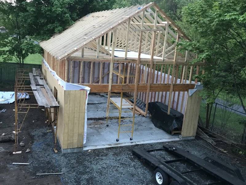

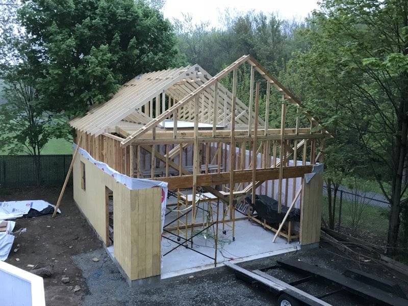

It seemed as though when I got to the roof, it was raining every other day. Then I lost all of my help. I was trying to put up trusses by myself. They were too heavy or I was too weak? I looked on you-tube and saw how this guy was doing it by himself. His were not as steep as mine, nor was his ceiling twelve feet off the ground. Does that sound like I am making excuses? I was able to use his technique and got the rest of them up.

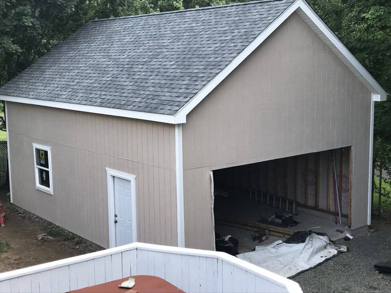

The garage is 22' x 30' and can fit more cars, but I have more stuff than cars. I also want to put in a bench and cabinets, compressor, mig welder, and etc. If anyone has a good design layout idea; sharing is caring. The last time I sheathed a roof was over 30 years ago, so this was difficult for the old man. I struggled to do one side over the course of a couple weeks (rain delays). A friend from work came by after hearing me cry for two weeks, he revealed he could do the other side in few hours if I followed his plan. On Monday we pulled everything need to the ridge. On Tuesday after work I sat on the ridge and passed him everything he asked for in sequence and three hours later we were done! I screamed Hallelujah, thank you Jesus. My neighbors thought I was crazy, but I did not care.

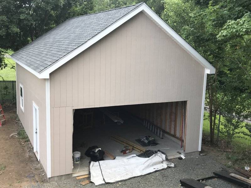

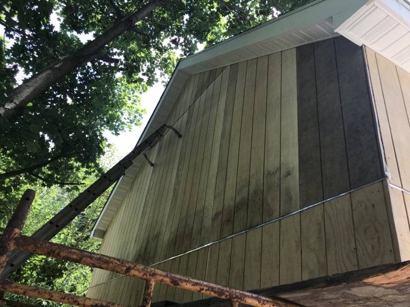

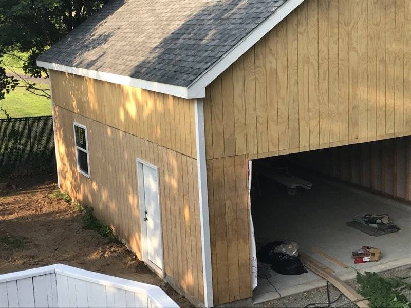

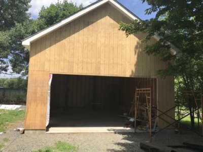

Then I finished putting up the siding and started on the soffits. The door and window then went in.

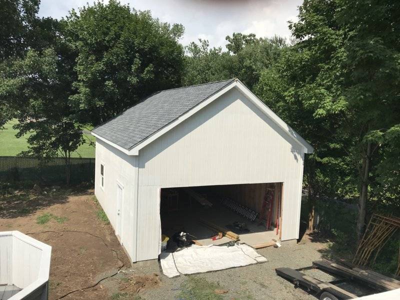

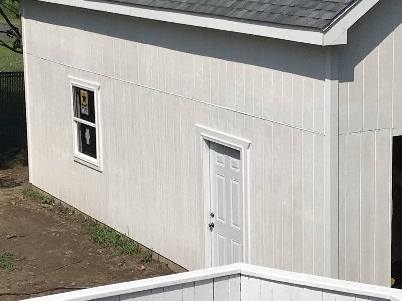

A friend of mine who said I am not helping you with the roof, it is too much work and I am too old to do all of that lifting said, call me when it is time to paint. I said ok. He primed it with a brush and roller to get the paint into the fibers.
Then came by two days later to lay down the color with a paint sprayer. He was a beast. He just kept working through the heat! God bless him!
