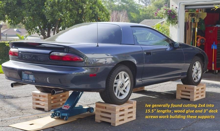

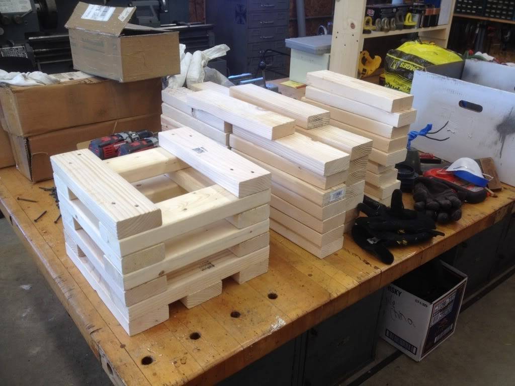

Here's some you can build, better than any plastic ones.

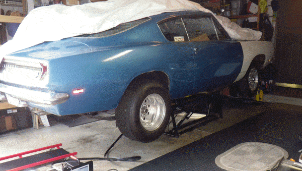

Or if you have a way of lifting your car, many shops build these.

I live in a condo - no room for anything. Don't even have a driveway. That's why I need space saving ramps. I think the Rhinos fit the bill for me. Nice and wide, easy to store and hold 12-16000 lbs. Thx for the thought though Nut. If I had a house and more space I could do more.

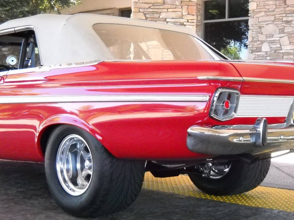

My back tires are 29X15.0R15LT M/T Sportsman Radials. Fronts are 205/70R15. The platform that the tire sits on is 10"W X 15" L X 6.5" H. They are some form of plastic made in a honeycomb design that would be next to impossible to fail. I usually use my floor jack to get the car up and then set these under the tires. I've only used the ramp section a time or two. I like these better than jackstands if I'm not messing with the wheels/tires. Very stable.
