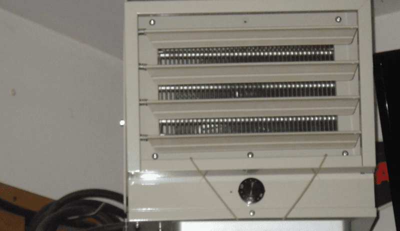

My garage is only about 3600 cu ft, ceiling is 6" insulated, and a R13 rated 16 ft. door. I bought a 7500 watt Farenheat 4 or so years ago. It's wired for 6250 watts, corded, and hangs on a hook so I can move it if needed. It has no glowing coils and can keep temps at short sleeve easily when I want it. Lol, one good thing about a small garage. I probably only needed the 5000 watt model. Even those are running 300+ bucks right now. There may be other brands that heat similar. Dayton's model appears to be the same as Farenheat.
