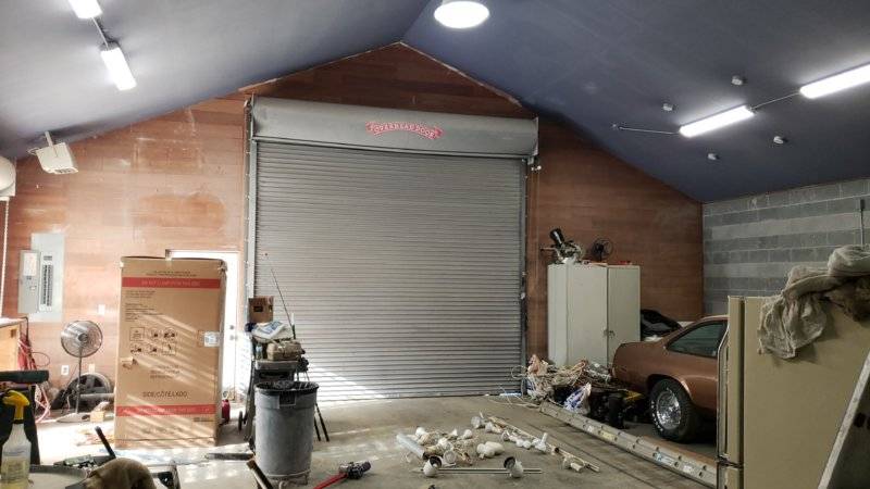

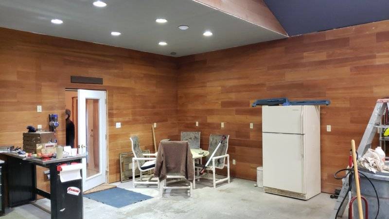

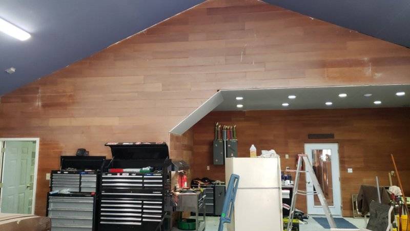

just to give you an idea of the space
I do have a chimney if i want to go wood or pellet stove
