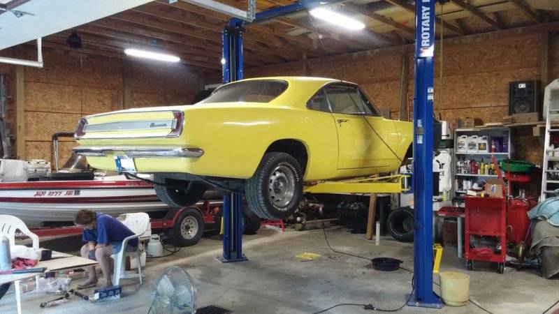

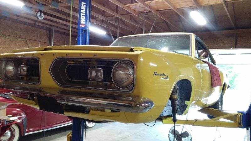

Attaching a couple pictures of inside my shop where you can see the lights. It's deceiving though, because it was day time and the doors were open, but at least you can see how I mounted mine. A white ceiling would make a world of difference though!!

Maybe it's the kind you are using. Mine diffuse the light pretty well. I know it's deceiving because the doors were open in my pictures, but if you look at the second picture, you can see how it is lighting up the surrounding walls. If my lights weren't on, those corners are pretty dark, even during the day with the doors open. I bought the cheapo Menards 4' LED shop lights. I think they were around $25 each.

This is great information. Thank you all for chiming in. There is a lot to consider. At $35 each from Sam's club, I can put in lights everywhere. I like the idea of lower task lights over a work bench area. I also like the idea of putting these lights on separate switches so you don't have to turn them all on unless you need them. I was just thinking a small fridge would be great. I don't drink alcohol, but having some bottles of water or Gatorade makes a lot of sense. Frankensteen that's a nice Barracuda. Pictures always make the idea come alive. I do plan to insulate and put up sheet rock, but I have to save up first. The white walls and ceilings will definitely make it brighter.
