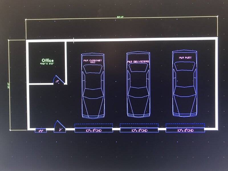

Here is a picture from my CAD program of a shop I am thinking of building that is 25'x 50'.
I placed a template of my cars inside to give an idea of size.
I do know with a ceiling height you are looking for the exterior walls need to be minimum 2''x 6'' or 2''x 8'' depending
on your local code requirements.
Also you will need spot footings were the lift posts are going to be for added strength.
The mistake i made on my first building was not enough space between the overhead doors. On my second building I spread the doors out so you can put stuff between them. There is room for a drill press or a workbench but mainly ample walking room.
