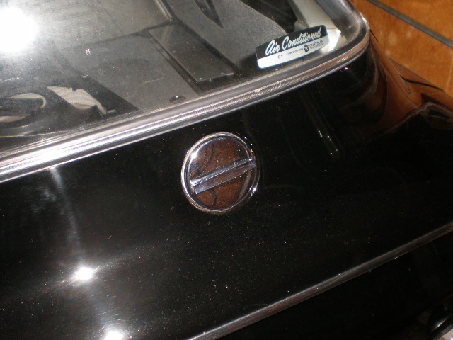

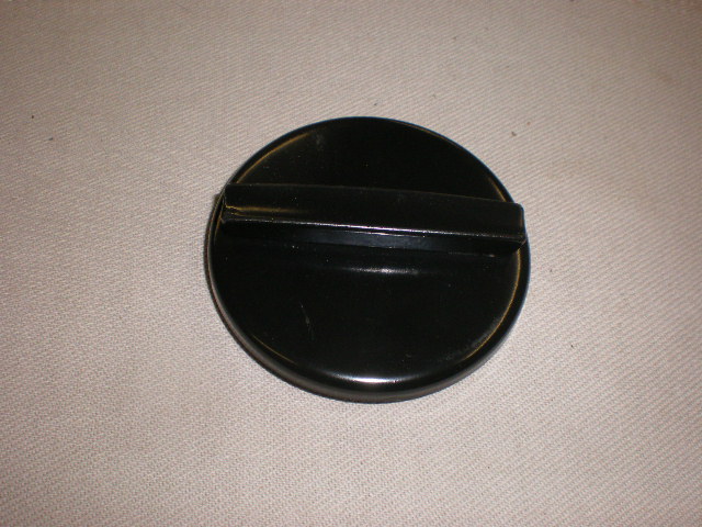

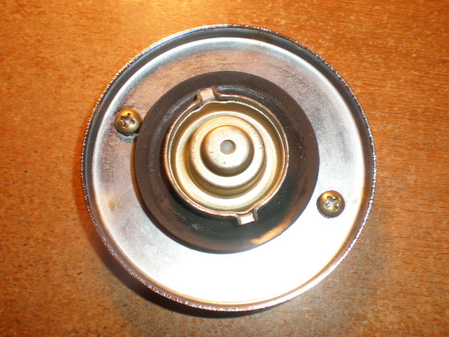

Rob,here is the correct cap.Also the cap from a 67/71 Dart is the same.Not sure ot the other Dart's.
That is the correct cap in the pic (same as a 63-66 A-body) 67-71 won't fit. Will be loose as 67-69 dart are a bit deeper where it goes into the filler tube. Will take pics tomorrow if you like. 1970 & up are different again (have 4 tabs instead of two)
Stant G27 was a replacement cap with the S-bar as the handle. Don't think they are avail~ anymore though...
63-66 Valiant, Dart or Barracuda cap is what you are looking for.

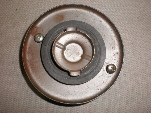

This is the cap that is on the wagon now,from 70 Dart Swinger.
