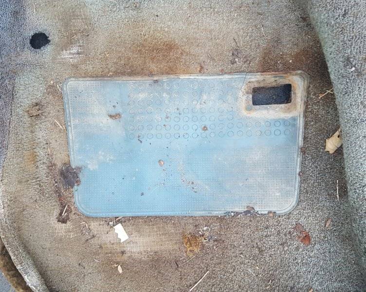

Gas pedal requires a section of the carpet, along with the upper right corner of the sewn in rubber pad, to be cut out.

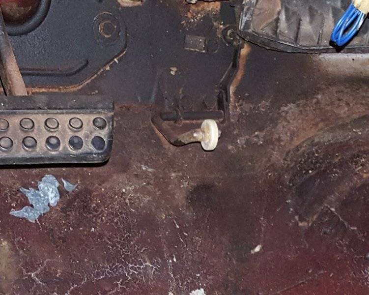

Tried going without a pedal but every so often the little white plastic wheel catches a tread in my shoe.
Is there a pedal that fits the existing rod and just hangs off of it?
Or another way to mount the re-pop gas pedal?

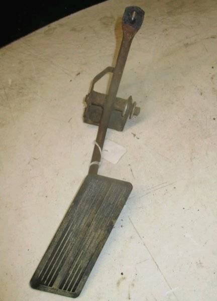

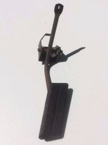

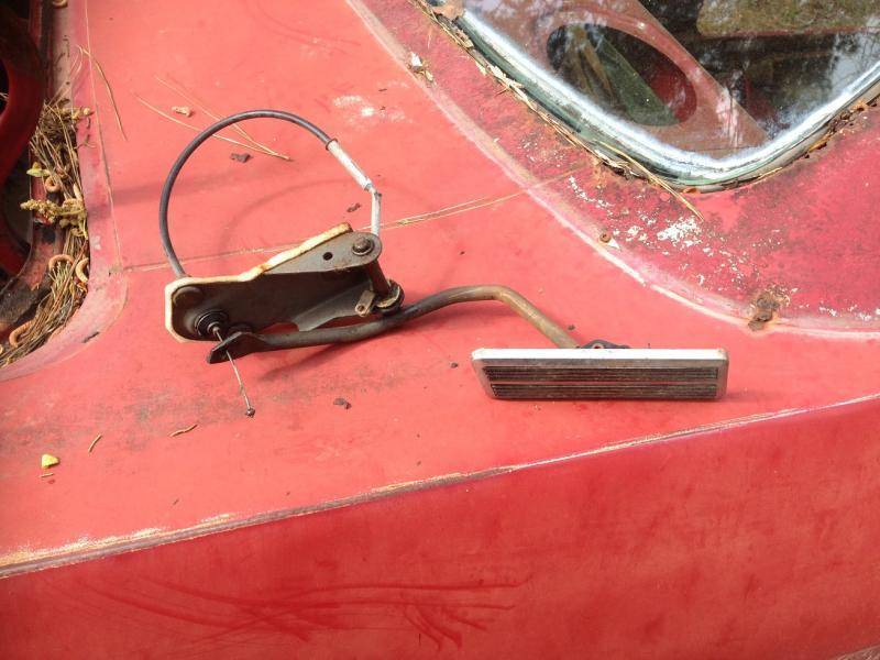

Use one out of a 68-70 C body or Cordoba They are a hanging style that still uses the cable, Also Ram p/us have them also! I have one in my 65 Ply. race car!
86 Ram
69 c-body
81-93 Ram
Ram ones from ebay look identical.
These might be a direct bolt on, I'll take a closer look at mine.
I keep thinking there's a pedal out there that will slip on where the little plastic wheel is currently.

On the bottom of the mounting pad, there's a smaller area w/studs, with the hole in the carpet, and seals the way it's made. Yeah, hole cut in the carpet, for the smaller area, outer edges flush with the carpet.

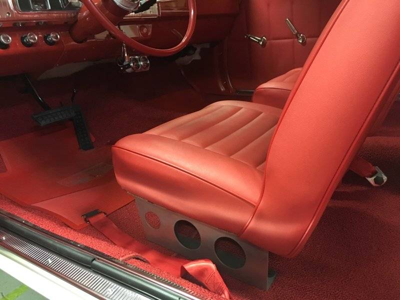

I did not cut a hole in the carpet of my 65. Just two small holes for the studs and it bolted in.
I cut a small area in my heel pad that's about the size of the bottom of the gas pedal (the small rectangle the studs are on). Fit right in with no issues. Crawled under the car with a sharp Phillips head screwdriver and pressed up into the carpet to poke through to mark where the studs go, then measured out a square and cut it with a sharp knife. Easy to do, but man was I sweating when I did because I didn't wanna mess it up.

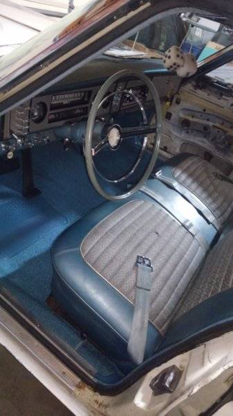

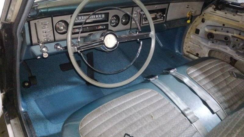

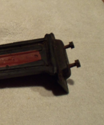

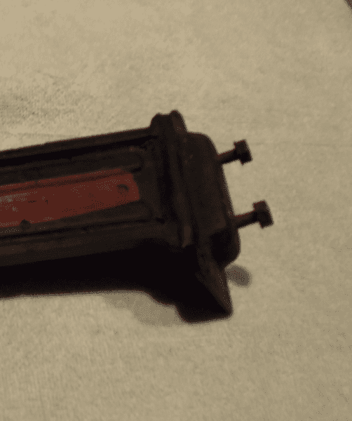

My original carpet, in the first pic, was cut straight through. The bottom of the pedal sticks down into the hole.
I don't think I can get away with just cutting the pad with the carpet and padding under it, plus not sure if the pad is in the 'correct' spot.

Unless I can find a pedal to fit the existing rod (old pic).
