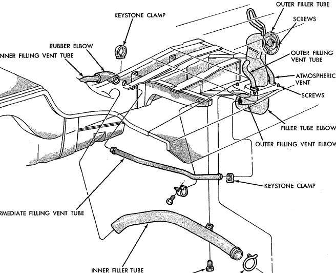

Here is a picture of fuel neck and tank, 1966. I'd maybe remove filler neck etc if you can't get at it in the car to clean vent tubes.
If this is true, this would NOT vent your tank. The vent MUST be to atmosphere.
I'll have to inspect when I get home later. The pic that Fran Blacker posted looks like my setup, which, I believe, it shows all vents going into the filler tube. I believed the vent was the cap, since it's gasket is spring loaded, and I assume opens under x amount of pressure.
I don't think that cap is vented which is why you have the atmospheric vent (see Fran's post)
Well, I'm not familiar with '67's system. I have '69's and '70's where the cap is NOT vented, the vent is on the tank or filler tube. So somehow your tank has to be vented to atmosphere or pressure will build up from temperature change. Maybe on your '67 the cap IS vented??

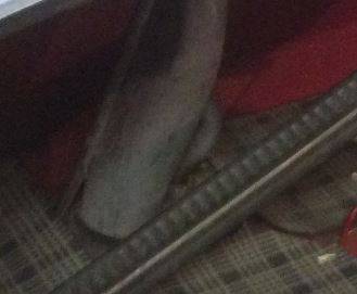

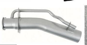

On the right of tiller neck near gasket it says vent to atmosphere. Wonder whether you could look up under car to see if there is a vent tube opening ? Been a while since I looked at mine.
I've been seeing more of this venting/pressure buildup going on since the fuels contain more alcohol and have a much lower boiling point now. Possibly the venting systems of old can't keep up with the amount being generated now? I know on my 65, after driving it for like 30 minutes or more I could here the fuel boiling in the tank after I shut it off. The TTI 3" pipes that were 1-2" away from it probably contributed to it but thats still not good.
You are correct, I do indeed have a vent to atmosphere, as shown in the right most pic right above this post.
I put a rag into the filler tube to catch anything that might blow out, and shot air in from the tube that exits under the car. I didn't see anything come out, but I did confirm that at least now that vent is clear. So the issue should hopefully not happen again. If it does, at least I ruled this out.
