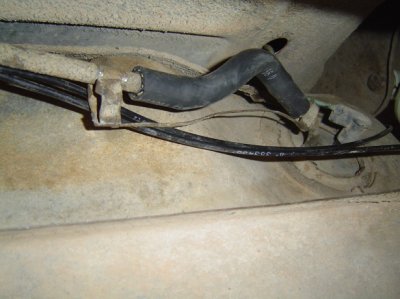

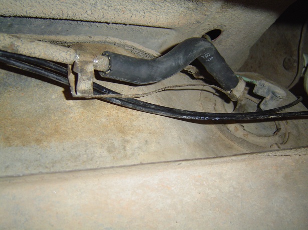

Can anyone do me the huge favor of finding me a picture of the location of the fuel tank ground strap? My gas and temp gauge are not working and I'm sick of running out of gas. If anyone else has any idea of a solution that would be cool too. Non of the fuel parts have ever been messed with or off the car so I'm not sure why it's not working.
The ground strap goes between the small section of rubber from the sending unit and the fuel line running to the front. You can also use a section of wire and a couple hose clamps. Make sure the lines are clean to get a good ground. Also make sure that the fuel guage wire is in good shape and connected to the sending unit. Good Luck
Is the sending unit the back of the tank with the rubber hoses coming out? Or is it located on top of the tank?
The sending unit is on the front of the tank, facing the differential, on the top half of the tank. It has the hoses coming out of it. I would check the condition of the hoses and see if the fuel gauge wire has a good connection.
Here is what my 73 looked like before I removed and replaced the tank.
