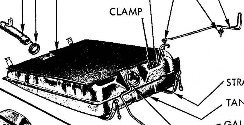

What's the deal with venting in these tanks? I ask because I have previously had issues where the tank held a vacuum and caused me to think I was running out of gas, but yesterday I came home from a run to the Mopar Alley Rally and shortly thereafter found a puddle of gas under the car. I popped the cap and it basically flew off the car, the tank was so pressurized. It was HOT out and I had just driven about 60 miles. I have not yet tracked down the source of the leak, but I DO NOT like having fuel leaks...
I've replaced my tank, and if anyone remembers, I modified it with an in-tank pump in preparation for fuel injection. Every single line and piece of rubber is new. The tank is new. The so-called "vent line" is clear and the hard line up to the filler tube is clear. I seem to remember somewhere that this car required a special cap or something. What puzzles me is that if I blow into the backside of the cap, it vents. And it's supposed to be a vented cap.

It was a small puddle, maybe 6" diameter. However, there is no loop of vent line or anything in the trunk. The only connections on the tank are the sending unit, the main fill tube, and another line that comes off the top and connects at the top of the fill tube. This is commonly referred to as the "vent line" but I can't see how anything vents with it since it just connects back up to the fill tube. I've seen other setups from 68-72 and there are a variety of them, usually with one line connecting to a canister or the engine to allow expansion and then burn the fumes. This has none of that.
Obviously you have to let air in as gas goes out- but is the tank intended to hold pressure like that if it heats up? I've been through this care front to rear and I believe the tank is setup correctly, but I have a hard time believing it should pull a vacuum or hold pressure.

Yeah, it's some Autozone cap... the one that was on the car was exactly the same, but the rubber was shot and I got tired of full tanks spilling gas out the filler. So I replaced it. The thing is it was listed as being vented, and like I said, I can put my mouth on it and push air through it. This is why I'm so confused. It seems to be vented. Second, there is no U-loop in these cars unless I'm totally mistaken. I don't have pictures of the tank setup in the car, but I'll work on it if I can't sort this out.

As for the Charger, I have no idea how the tank can't have SOME kind of positive pressure relief. I think the cap may be part of the problem, but I would really like to know how this setup is supposed to work from the factory. I'm wondering if adding that kind of U-bend in later cars off the fill tube is a solution? If a cap can solve it, that's good enough for me though.
