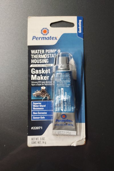

Just remember that with any of these "RTV"s that you use a smear only. Otherwise the squeeze out will be in the water passage and block something up. I have never used anything but Aviation gasket sealer in my 45+ years of wrenching these things and other than **** Corbin clamps never had a leak.
