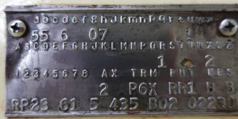

I'm new here and don't know if this is the right place to ask but could someone please help decide a fender tag for a 1967 Plymouth Satellite 383 auto, all I've been able to decipher is RR1 is burgundy, so looks like it's had a colour change, I'll put up a pic of fender tag.

RR1 is bright red in 67. QQ1 is burgundy in 67.
You have a 383 2bbl automatic, AM radio, fender mounted turnsignal indicators, and I believe 2.76 rearend non sure grip. It's bucket seats, buddy seat, so automatic on the column. Also black interior.

Exactly, well its been repainted pale yellow now but the rest rings true....Bet it looked fantastic when it was bright red!!!

Code P is bright red in 67, and code R is yellow. Code R is burgundy in 68.
You are correct, I didn't look it up. My old brain is messing with me. Thanks.
Maybe someone can chime in on the d6 option, otherwise here's what your tag says.
CAR: Plymouth Satellite 2 Door Hardtop
ENGINE: 383cid 2-bbl V8
TRANSMISSION: 3-Speed Automatic
TIRES: 7.75 x 14 WSW
MODEL YEAR: 1967
BUILD DATE: November 02.
AXLE: 2.94 Rear Axle Ratio
INTERIOR: Premium Trim Grade, Vinyl Bucket Seats. Black Interior.
PAINT: Yellow (Dodge, Plymouth), Daffodil Yellow (Chrysler, Imperial).
OTHER: Black (Dodge, Plymouth), Formal Black (Chrysler, Imperial) Upper Door Frame Color. Black Horizontal Accent Stripe.
MOLDINGS:
ABC OPTIONS:
R1: AM Radio
X2: Tinted Windshield Only
abc OPTIONS:
a5: Center Front Seat
b5: Rear Arm Rest w/ Ashtray
d6: Unknown Option
g0: Chrome Belt Line Mouldings
h7: Fender or Hood Mounted Turn Signal Indicators
u1: Sold Car When Built (Somebody Ordered It)
I have a 67 Belvedere II. My Trim Tag has the d6 code also, and I get the same info it...Unknown Option.
A2 is a 2.94 ratio with an 8 3/4 rear end.
