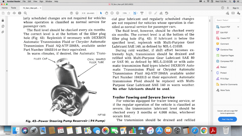

Bottom of the filler hole.

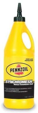

I just gave it the extra 1/2 pint and put in the whole gallon, some of which will leak out as you try to install the plug anyway.
I found the 85/90 too thick and cause a gear clash. Swapped it out with Penzoil Synchromesh and she shifts like butter.
