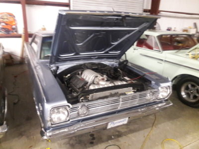

I put a 5.7 in my GTX and I used the radiator from the donor 07 Charger. Works fine and has never overheated. It IS hard getting used to the fact these motors run very hot, 205+or-. I double checked this against my '13 Charger with a 5.7 and it runs inn the exact same range as the swap does in the GTX. I did have to make a custom cover and "puke tank" though as the o7 overflow would not fit anywhere due to it's shape.
