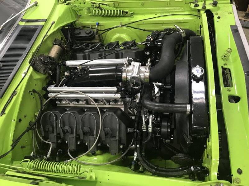

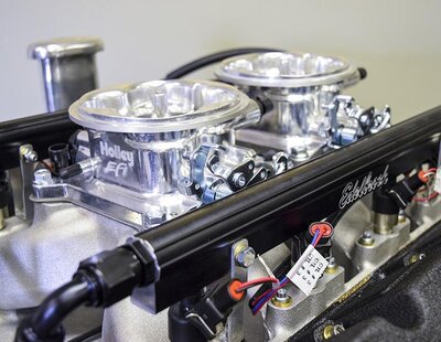

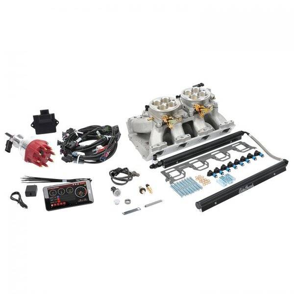

Just go EFI and be done with it

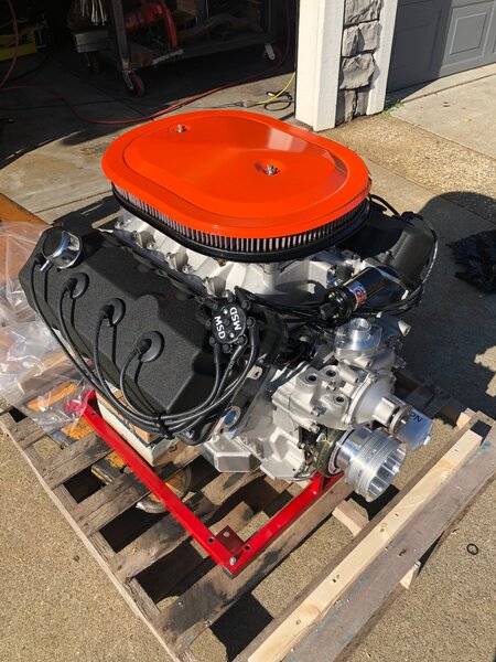

The hemi i bought from Tim has almost the same set up as Mancini is showing. Haven’t started it yet but it looks really fast.
The learning curve is dependent on your willingness to actually learn it, it is not that hard especially with the internet and a wide variety of books out there as well as your computer skills. Yes, it does take some learning but what you get back is worth every second especially if your are running a system that controls fuel and timing. You can adjust a wide array of things sitting in the car, no wrenches needed not to mention the fact that it will adjust itself for things like altitude, air density, etc. You can adjust cold starts, idle settings, fuel enrichment and timing anywhere in the RPM band, etc. If you want to get the most out of it EFI cannot be beat.
That said, if this is a limited driver or perhaps racer then carbs will get it done as well.
I've thought about that too. Does that system change the height, as it would affect hood clearance ? I'm not really up on any modern systems, so I'm thinking a Major learning curve would be needed ?

With the set up i showed u i had to remove the 1” spacers as it was hitting my hood TIM said i probably lost 20hp but so I’m still about 750 more to go.
