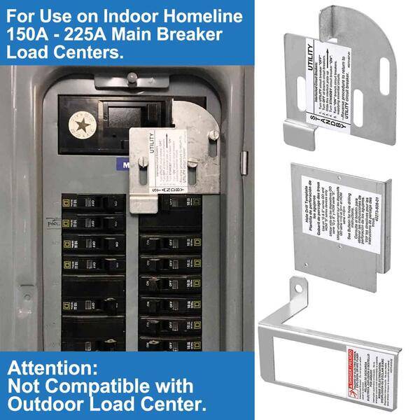

A generator interlock kit is a safe and cheap bet for the power switching. Not allowed here in Ontario. Reason they say is because the interlock attaches to the panel cover. If the cover is removed the interlock is useless.

That interlock is what I was seeing on a lot of the videos, so I’d use one.
