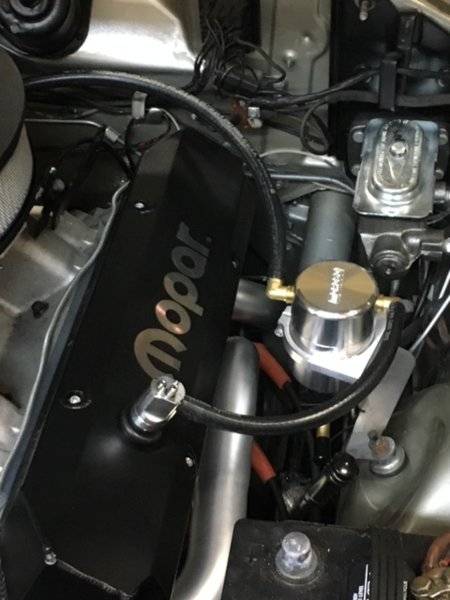

My .02, is your lope/lack of is due to the air leak (lean) as stated above. Did you notice a higher idle rpm? I'm Still tuning on my 512, but I'm using the wagner valve, and a moroso inline catch can. This things pulling crazy vacuum when the carb slams closed. I think the baffles in the valve covers are wrong as well letting oil slosh get pulled up into the valve. At this point im just glad I'm no longer pulling oil into the intake...
I looked at Moroso catch cans. Can you give details about the can? I only see catch cans for modern cars. Thanks
I'll have to do some digging, they sell a plethora of mounts. And yes, they are for "newer" cars. I'm 99% sure the mount I found for mine was (gasp) for a mustang. I'm out of town until next week, but can get a better picture and hopefully the invoice with a part number for you. The one I ordered uses a single nut to mount to the shock stud. no drilling on a freshly painted inner fender. if you go to Moroso's website, you can browse pics of the different mounting brackets.

Jdakrt thanks. I was thinking the can had to be for another car
