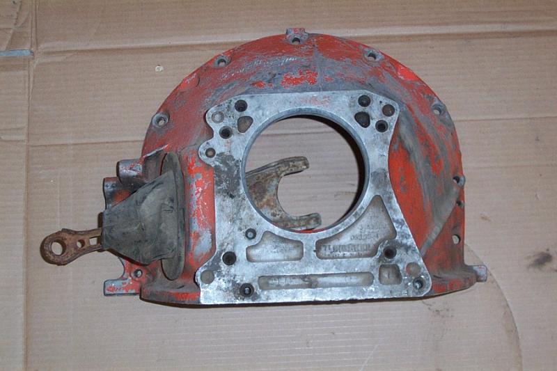

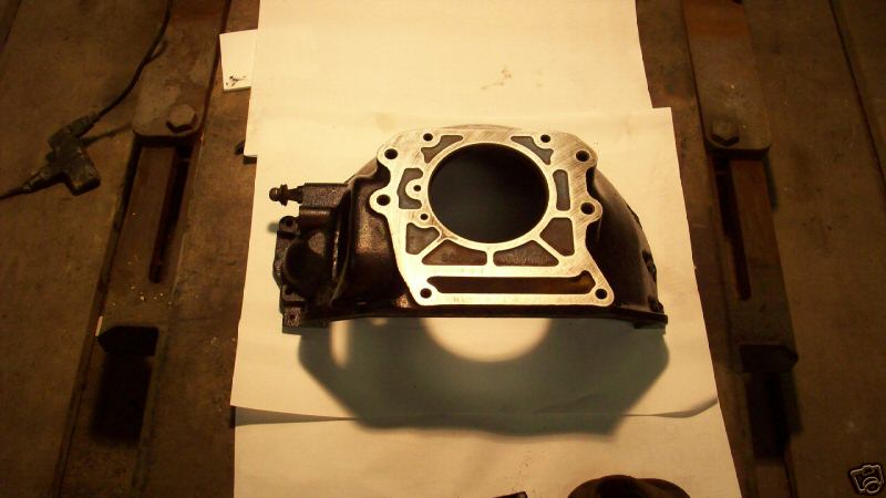

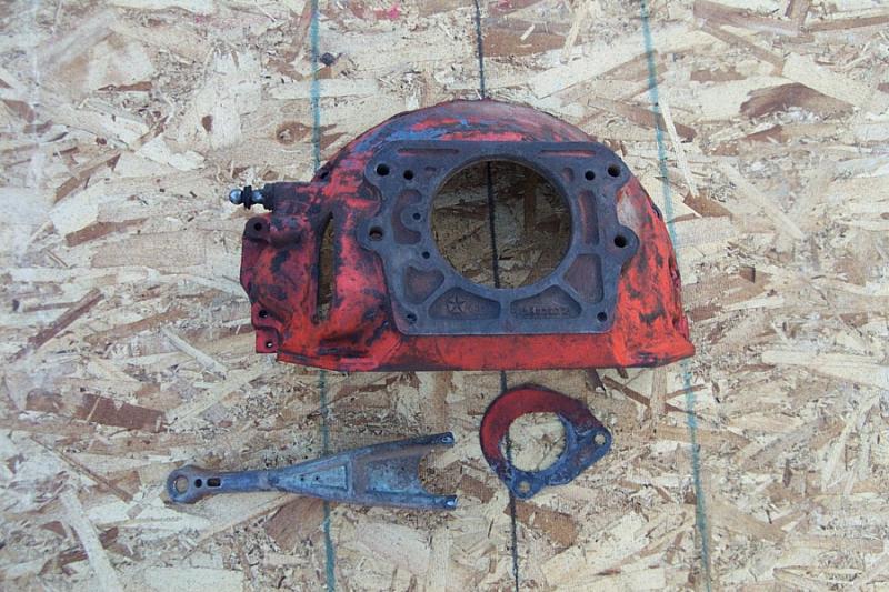

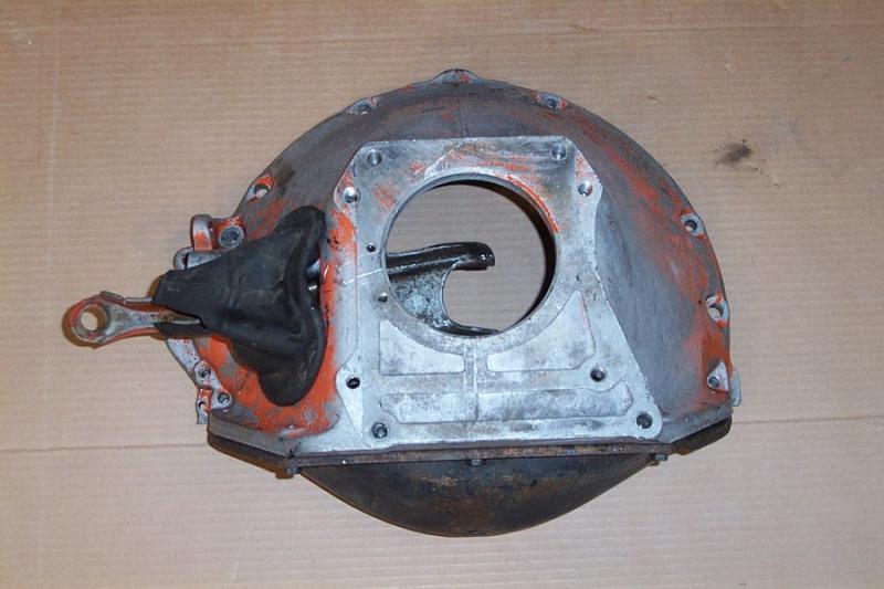

Chrysler made only one bell housing that will fit the 833OD to a big block and is very hard to find. Here is a pics. Was made in the late 70's. I had one about 30 years ago a sold it cheap without knowing what is was. I was just at the Fling in LA and a guy had one for 300.00. It was only the 4th one I've seen in 35 years. I've had tons of the other BB truck bell housings that fit the NP435/445 tranny but not the 833OD. This bell fits both the 833OD and the NP435/445 trannys. Notice the dual tranny mounting patterns? Both the 833OD and the NP435/445 have the larger 5-1/8" front hub. The car BB bells have a small hub hole.
Sooooooooo your options are:
Find the hard to find bell housing
I think someone make an aftermarket steel bell that works
Machine down the 833OD hub and machine out the car BB housing hub hole to match. This is the most common way.
Top is the dual pattern bell Fits both 833OD and NP435
2nd is 70-up BB fits 833 Hemi tranny front hub. Smaller than 833OD
3rd is the standard BB truck bell. Fits NP435/445. Not 833OD
4th is the Small Block 833OD bell. Used in both cars and trucks. There is a early and later version with different T/O arms

If you have the bell in the top picture then yes, the hardest part is all ready over.
Also need to note that the cast iron truck bells use the 143T flywheel and the other two shown use the 130T wheel.
