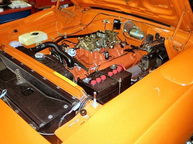

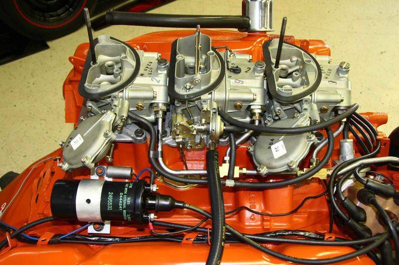

                                  The main thing for me, especially with the '69 1/2 carbs was take the plugs out of end carb idle mixture screws & richen them about 1/2 turn & put a screw in the slot so at full throttle on the center carb, the end carbs crack a little bit. The '70 carb end carb jet plates seemed just about right, 2 numbers up in the center & maybe 2 numbers on the squirter. Try the different springs in the end carbs & see what it likes. I had the aluminum manifold, never played with the iron version.
                                  • Thanks! Thanks! x 1

                                    Everything you said other than the screw in the center carb linkage,but thats your choice.However once you get it working right,you'll never go back !

                                      The screw in the linkage was my "fail safe" to get them just cracked. So many of the early stuff would stick then pop open. With a little tweaking 6 Paks were great. Now I'm kicking myself for selling the last one I had.
