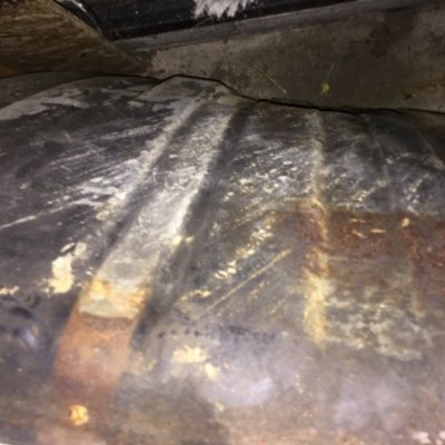

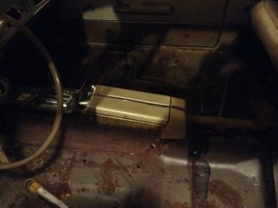

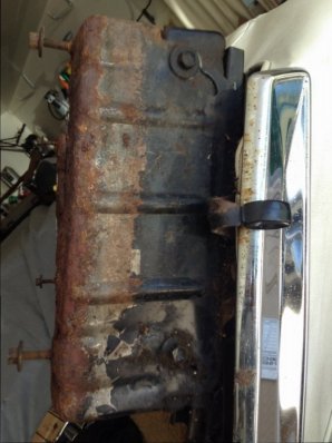

Well, I picked up this 65 Coronet 500 a little over 3 years ago. Finally got some funds freed up now that the loan is paid off. I've done a little work here and there, nothing major. Took out the raggedy shredded carpeting. I've been cleaning up the bottom as I've had some free time. I dropped the gas tank last fall and was surprised how clean it was inside. So my brother popped the dent out and I checked to make sure it had no leaks, I cleaned up and painted the bottom of the trunk and put the tank back in. When we first got it my brother looked it over and was able to get it running after rebuilding the carb and getting a new Carter fuel pump. I also replaced the water pump and we had the old radiator repaired, though an aluminum one will be put in a couple years. I recently picked up a front disc conversion kit and will be putting that on soon. About a month ago, I pulled the rear end out and my brother is going through it. New bearing, larger drums, checking the sure grip and putting in new axles after he narrows it an inch per side. Will be putting new brakes lines all around and my brother has a dual master cycle from a donor car for me.

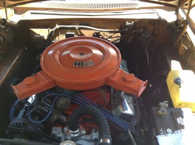

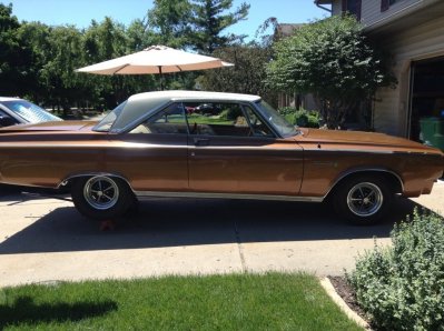

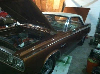

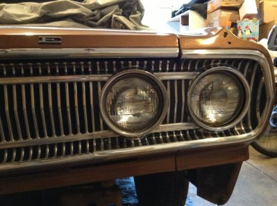

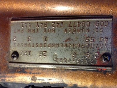

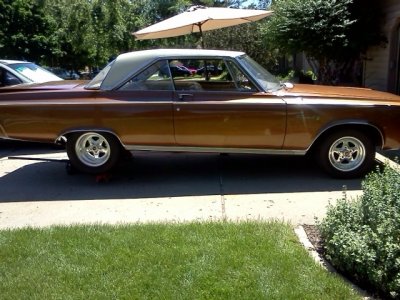

It looks like it started out as an AA1 (gold) 318 automatic with white interior and vinyl top, gold carpet born 12-9-64 according to the broadcast sheet, yes it was there. From what we can figure out someone took the car apart 20+ years ago or so and changed the color from the original light gold to this med brown metallic. They put on SS springs, dropped in a D 440 hp, I'm guessing from a roadrunner as they also put the beepbeep horn under the hood. Chrome Dan straightened up, polished and painted the grill. Picked up some Weld Pro-Stars but the backspace is only 4" thus why we decided to narrow the rear end since we were going through it anyway. It'll probably need either the floors replaced or patched up. I'll get it drivable soon and keep restoring/ maybe working toward a resto-mod or track car (I like what 65roadracer is doing with his 65 Plymouth).

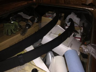

My brother replaced the front bushings on my leaf springs. I've gotten the leaf springs cleaned up and first coat of rattle can on them. Want to get a few coats on them and then clean up the rest of the floor and mounts before putting it all back in. Unfortunately, It's been slow for my brother to get the "new pole barn" shop up and going. Not sure when I'll get the rear end back. May not make Mopars at the Red Barns on the 30th like I was hoping or Woodward Dream Cruise. I've haven't given up hope quite yet, but it's already the 10th.

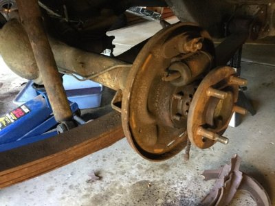

I was able to get together in July '17 with my brother to start getting the rear end narrowed and re-built. We got it narrowed, cleaned up and painted. Then he started having some health issue and issues with work. It got shelved until December. We were able to get it put back together just before his cancer surgery in Mid-December. He bought Strange axles and had some 11'' drums that he put on for me. It's been sitting in my cold garage until this week. Thursday afternoon, I was able to wrestle the springs back on by myself. When I went to put on the new stainless brake lines, I discovered that they are wrong. The packaging says they are for 62-65 but they don't line up to the split block and vent. I believe that this rear end may be is a 68 or 69 489 case with 3.23 sure grip. The 440 in the car is a 68 D 440 hp block and we think the rear end probably came from the same car. I looked up lines for a 68 Road Runner and the shape and length is very close to what I need. I could also look into building new lines. My brother also has a dual master cylinder for me to put on. Hopefully I'll get the rear end re-installed in the car very soon.

I got the rear end put back in and the drive shaft hooked back up yesterday. Still need to get the brake lines squared away and see if the emergency brake lines are going to work. Unfortunately I got to work in the yard today so I don’t know if I’ll get anything else done this weekend. I have to ask my brother to figure out the proportioning valve and maybe put in a line lock too.
and this
Got the rear brake lines today. So I believe that the 489 rear end probably came from the car (maybe a Road Runner) that the 440 engine came from. If I remember correctly the D 440 on the engine pad means it's a 1968 and the 1 30 is the year month. So this would have been in a 68 (fixed, thanks dadsbee) vehicle. So I looked up the brake lines for the rear for a 68-69 Road Runner and the shape looked right and the length was close to what I needed so that's what I ordered. They fit with just a little tweaking since the rear was shortened an inch each side. After talking to my brother I decided I'm going to take the e-brake cables off too. The passenger side is way too long, it needs to be the same as the drivers side which looks to be correct. He had some nice SS cables so he put them on but now they'll come off. Hope to have time by this weekend to get them off.
