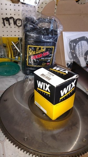

Fred has a 440 with a factory heavy as hell 11" flywheel, as provided by Brewers a few years ago:

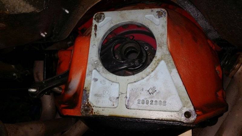

The bellhousing is a factory cast iron hoarker as well:
2892262 part number....

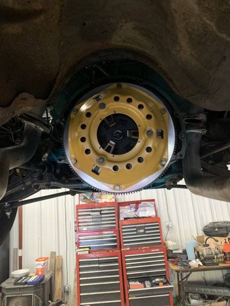

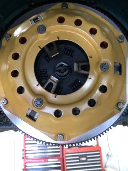

I purchased Bogs and Warner 3 finger 11” Clutch from Jamie Passions in Pennsylvania. He is also rebuilding my 18 spline transmission ,picking it up on Saturday. I’m also giving him my old Clutch and pressure plate to rebuild to have for a spare…
