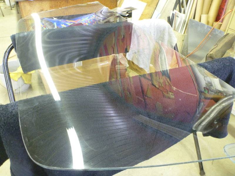

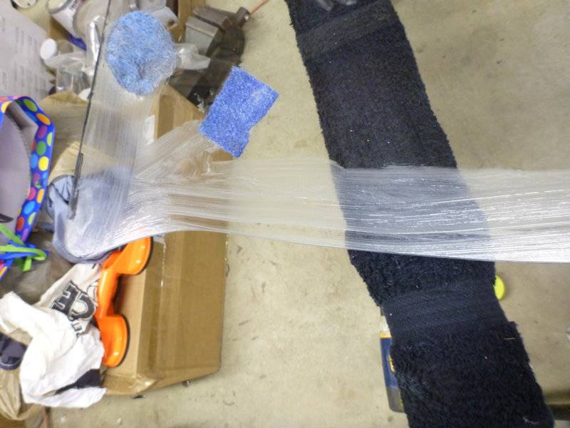

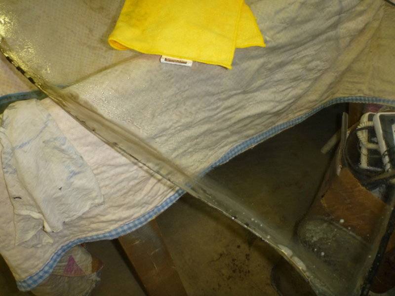

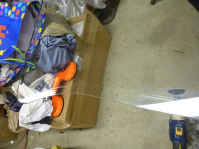

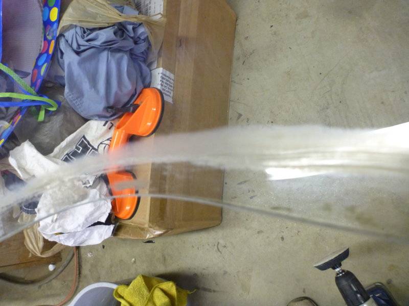

The glass I picked up yesterday has heavy filth along the lower edge from leaves and gunk rotting on it for years, and then sitting in an attic for another 30 years to bake it on.
I tried everything I had, acetone, reducer, gasoline, varisol, WD-40, Windex, glass cleaner, even the cerium polish with the buffing pad. None even touched it after 2 hours of farting around.
Went in for late lunch and complained to the boss that I was getting nowhere. And she handed me this.

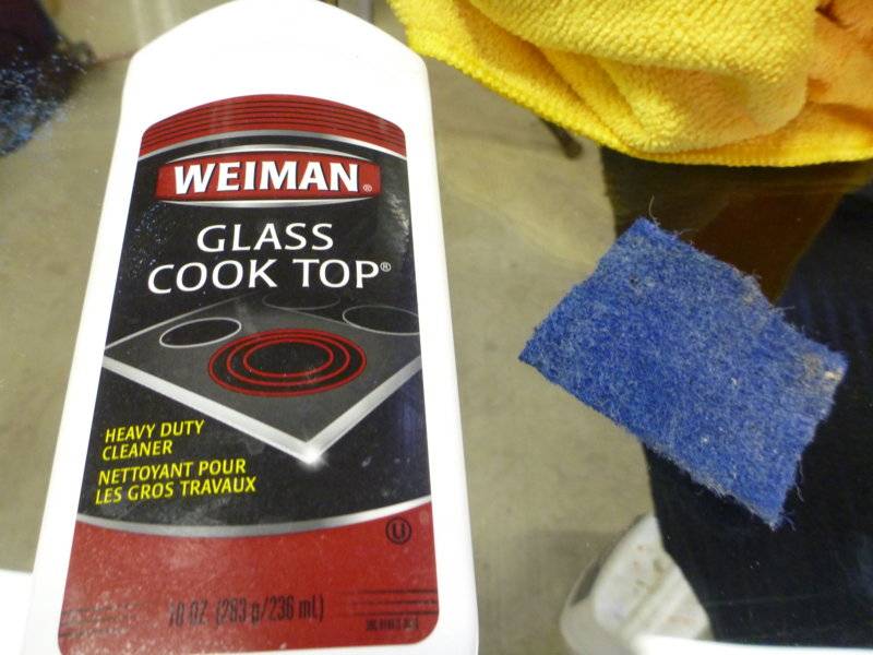

Cook top cleaner, a bit of water and the scrubber + a bit of SOS scrub pad lightly.
10 minutes later we have the cure and next time I'll just ask the boss first! Still needs lots of work, but I at least have a method to clean it right up that doesn't scratch! It also seems to remove light scratches in the glass.

Home Depot sells the Weiman brand. Going to try it with the buffing wheel.. ON THE GLASS I ALREADY MESSED UP! LOL

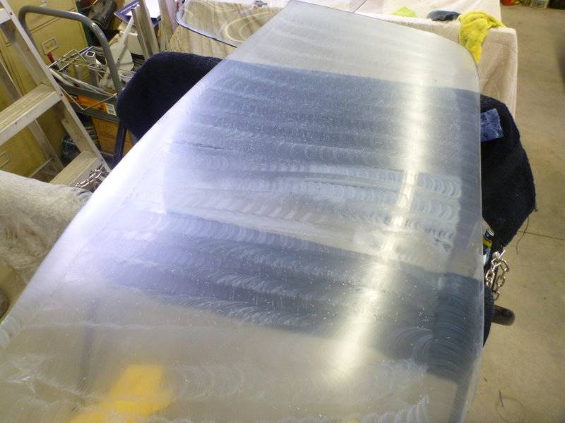

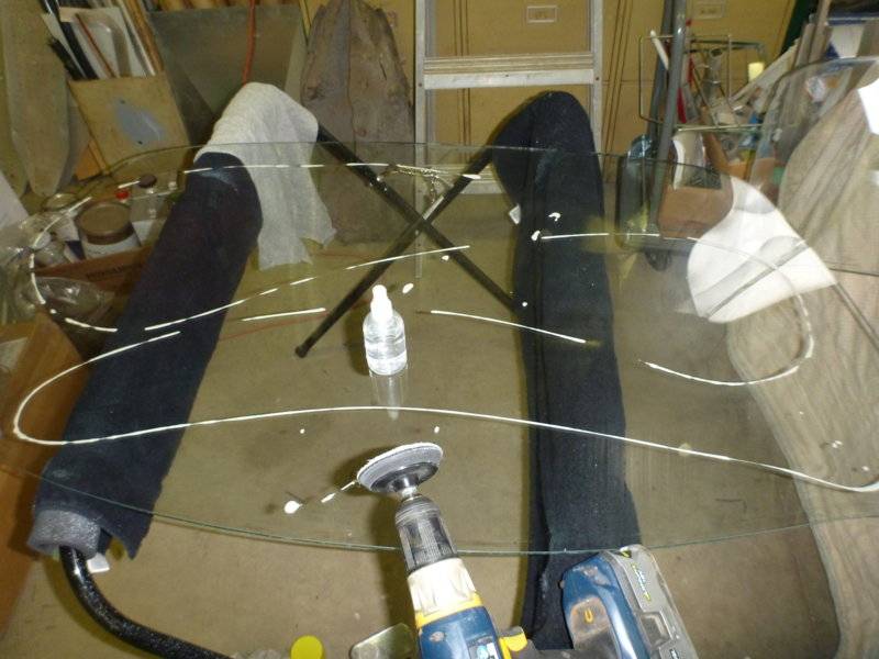

AGREED... do NOT use a scotchbrite pad anywhere on car glass. It may look clear to you, but look at it from a few angles and you'll see you've created haze on the glass. The different looped scrub pad that came with the stove cleaner, I only used around the edge to get rid of the baked on crap. The SOS pad, that is probably 000 or 0000 steel wool worked well too. All the open glass I just used my buffing pad that came with a glass polishing kit and the stove top cleaner. Same deal as when I used Cerium. Put some on the glass, spread it around and mist water until you get a nice spreadable smooth running cream.
One back glass done and doing the second today and then picking my best one.
