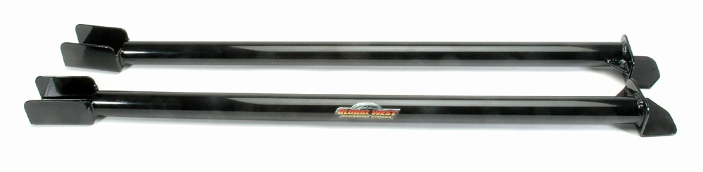

Just ordered a set of global west subframe connectors wondering if anyone's running these, they look nice and have good reviews,they are the tubular style. Also if anyone wants to give me any tips for installing this is my first time installing connectors.

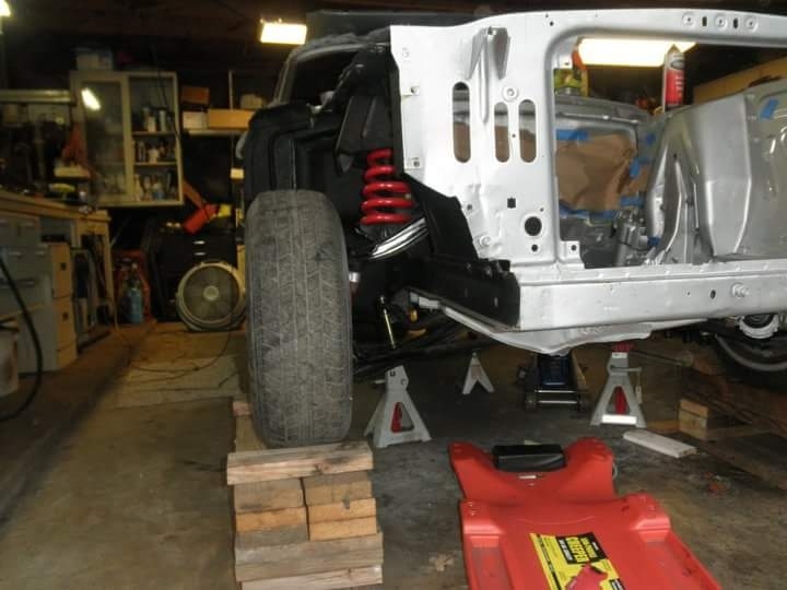

I took some scrap 2x6s and built raised platforms that are about 12"-14" tall which allowed me plenty of room to slide around underneath.

FWIW.. I also have Global West Frame connectors. I installed them with ramps on all four sides.
Did you weld to the floor pans? From the pictures I see it doesn't seem that the tubes would ride up against the floor pans close enough to weld there
They weld to the frame not the pans...

The global west are round, I've installed 3-4 on different cars and have never done that. Doesnt really serve a purpose that I see and unless you have a very flat pan would be more work than I could imagine.
Once installed you could have anywhere from. 1/4" - 1" gap between the pan and the connector...
