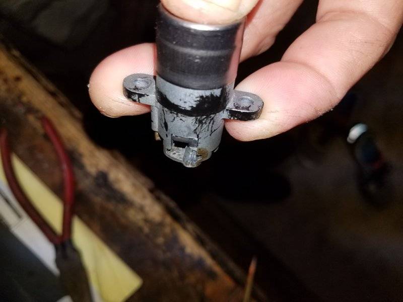

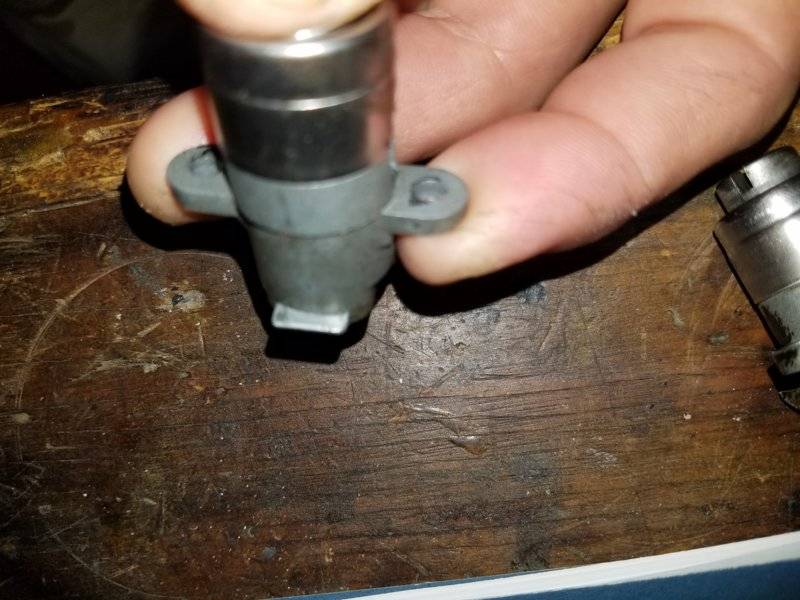

The lock on my glove box broke I want to change it out I have another one how do I change the Tumblers to get my key to fit that other lock thanks for any help I can get. You can see by the pictures that on the back of the part that latches another part broke off which comes up through the cylinder

I do not have pictures but the chrome cover is crimped on at a spot on the sleeve. You can carefully pry edge up and remove chrome cover exposing the lock parts with springs. Not hard to do for the early ones.
I'm going to have to give that a try I know that answer you gave me was from a long time ago
