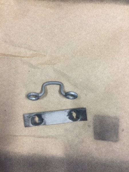

I have a 69 road runner I’m putting the dash together on the table. The door strike I have does not seem to line up to any holes am I missing something any help would be great. This is the door strike I have but seems too small just PM me thank you
That does not look like the latch on my 69 Road Runner.

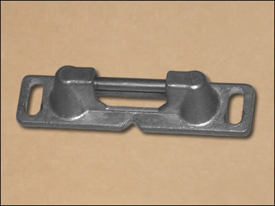

Just a picture from internet, but this is what mine looks like from my '69 Coronet.
Available new from Classic Industries and Tonysparts.
