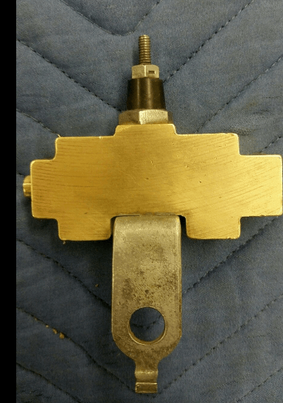

Well after reading the advice here and looking at a bunch of disc brake kits, and checking finances, I think a good way to go is a basic front disc brake kit, about 400, then a stock style 67 dual master cylinder, keep the power brakes. My single M/C just goes in a simple distribution block, and I'm assuming the dual M/C will need a different distribution/pro portioning block/valve and some brake line mods? Shouldn't be too much work, or money. What do you think?
The master cylinder the fittings are not normal size. I f you buy adapter fitting I bought a pair and they bottomed out before seating. Be careful if you go this route. I'd buy a distribution block from a 67 to 69 car with fittings. Ehrenberg sells fittings Ebay $18.88 under mopar brakes search. I used a after market adjustable brake prop valve. I think front brakes line to the rear hole in master? The way I did it. http://www.ebay.com/itm/NOS-Mopar-M...ash=item33c6b8db59:g:uxcAAOxy5jxScGND&vxp=mtr
The lower block.
