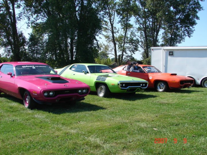

Either the hood on the green car or if it is an Airgrabber then like the pink one and they could have bench seats
