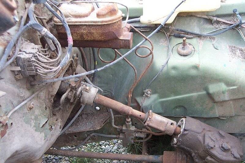

A-bodies were available with manual disc from the factory unlike B and E bodies. I've those master cylinders on B/E bodies with disc/drum like yours with real good results. Can use a factory manual rod for that year B-body. Factory 4-bolt mount. This a 71.
