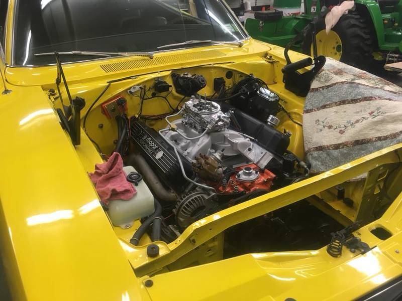

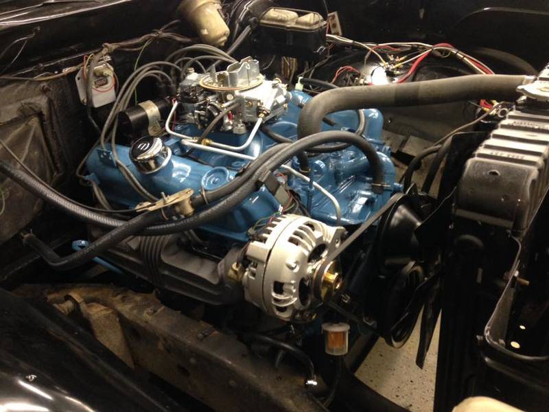

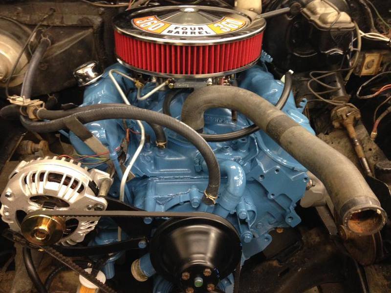

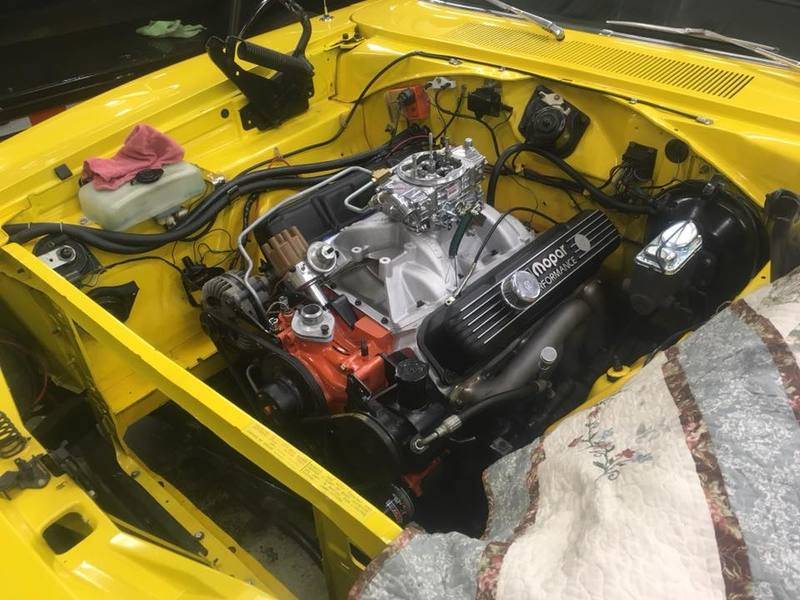

I made mine. I don't think you are going to find a source for custom setups. Hell, I had a hard enough time just finding a hard line for the big block in both my Runner and Charger that didn't run into the distributor for a Holley carb. I made a hard line from the fuel pump to my Holley on that and on my Power Wagon. Roll of 5/16 fuel line and a cheaper hand bender and you can be dangerous. Give it a try it isn't that bad and you can taylor it to your application.

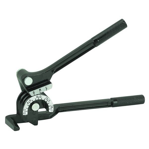

Well I'm in luck, Dad has the flaring tool and good rigid tubing cutter, just need to buy a bender and some hard line.
Go to Harbor Freight if all you need is an inexpensive bender. They work fine for minimal projects...

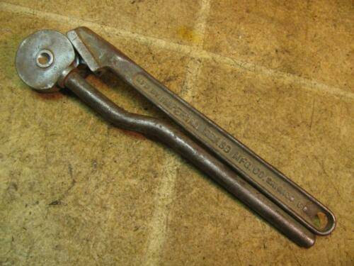

So I upgraded to something like this.
Not this one, but lots of choices out there for "heavy duty".
Wish someone would make a good hobbyist priced beading tool for steel.
