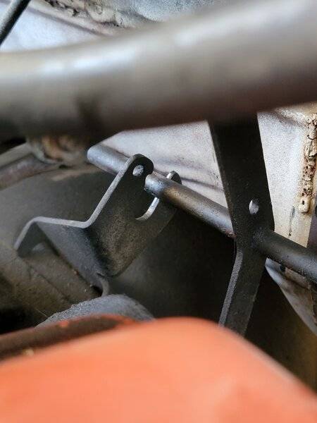

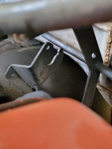

Hi everyone, I just got myself a 64 chrysler newport, from what I've researched it's the b engine 361 v8 5.8 Liter, my problem is my throttle linkage is missing a clip and my pedal sticks sometimes due to popping out of place. Can anyone help or show me the clip I am missing I will add some pictures for reference.

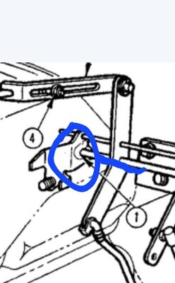

This may be your setup. If so it looks like you are missing something. 14-40 in the manual.

Thanks beep beep but it looks like I'm missing a part to my firewall bracket which is detailed as #1 in the diagram

Thanks! 1wild RT that's exactly what I need now as for the 10 inch rod that is 3/16" you think I can pick that up at home depot just as a substitute? And this I'll be my first time working on car since I just got it 2 weeks ago

The rod is just used during setup, if you leave it in place the throttle linkage will be locked up....

That rod just aligns the linkage so you can adjust the nut in #4 position. So that the geometry is correct. Once you adjust it you remove the rod.
Read what it says here.

GUYS! I got that bushing but it seems too big for the firewall bracket... can anyone tell me the correct bushing I need ...
