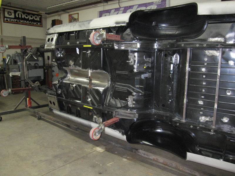

I bolted the Belvedere back on the rotisserie this PM. All I've got left to do is weld up the drive shaft loop attachment, the bulkhead wiring hole, and mount the VA unit to the inside fire wall!
Then it's ready to go back to the body shop for finishing. Mike

Thought for a moment you were talking about a chicken!
I spot several improvements...
Front torque boxes, frame connectors, relocated leaf spring mounts, larger trans tunnel....
Look closer and you can see the inner fender braces and the e-brake cable routing tubes, and the square tube for mounting the transmission cooler.
