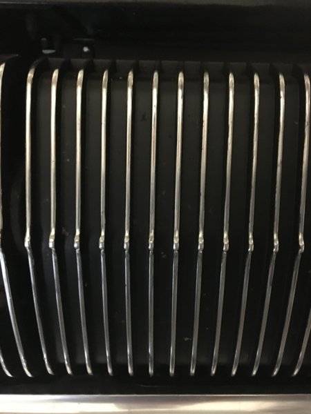

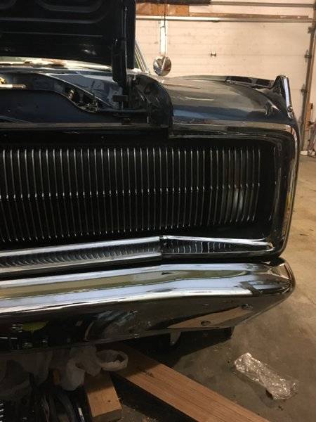

Anyone know what finish the black painted portion of the grill and lamps would be? I pulled it out to give it a small makeover.

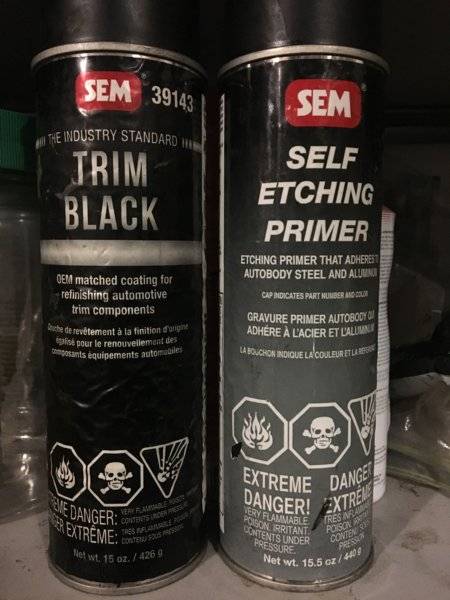

I’d recommend SEM products.
1) clean ruthlessly

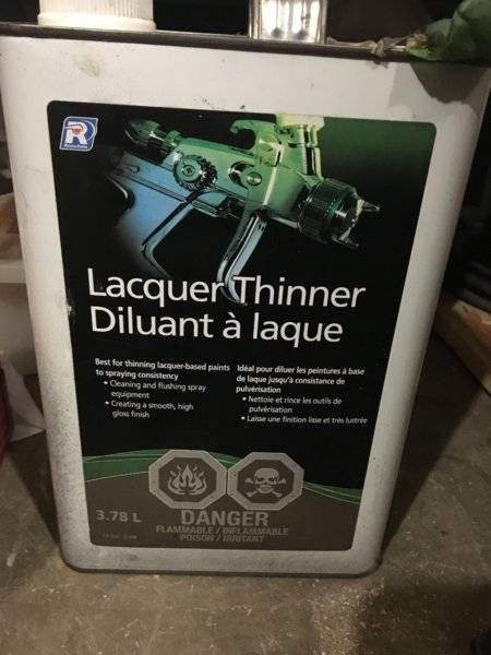

2) apply etcher in sections, not all pieces at once. Use lacquer thinner to wipe overspray immediately. Wait to dry.
3) apply 2-3 layers of trim black (it has a satin finish/wrinkle finish). Also use lacquer thinner on shiny bits here too. Allow to dry between layers.
Sound like a lot of work? It is. But you can break it up. And do it right once, not poorly several times. Additional layers will have mechanical adhesion, and provide extra UV protection. Should be stronger. I still have a few areas where 100+mph bugs will mark, bit it’s pretty good. Also beware of fender spears and rechrome (67s), even etcher doesn’t hold against car wash hand sprayers. Try to to power spray directly on the black paint.
