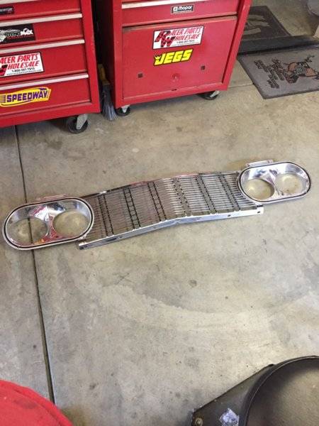

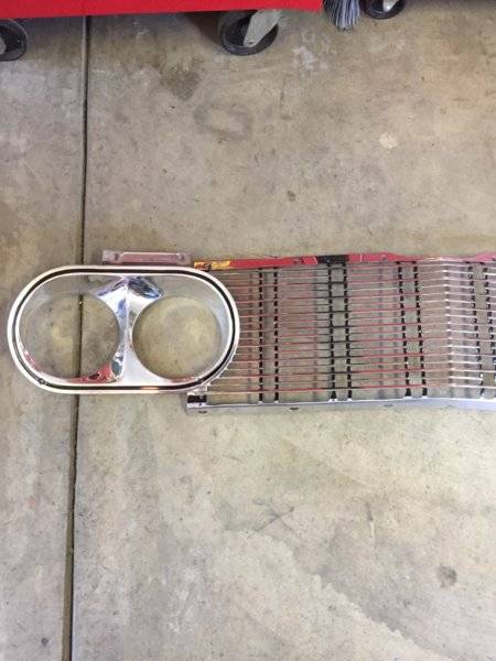

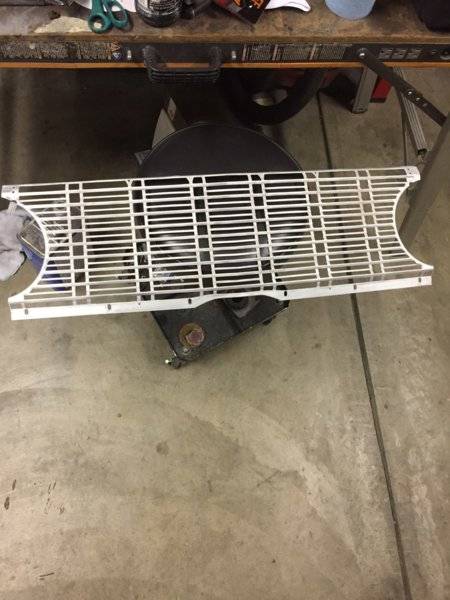

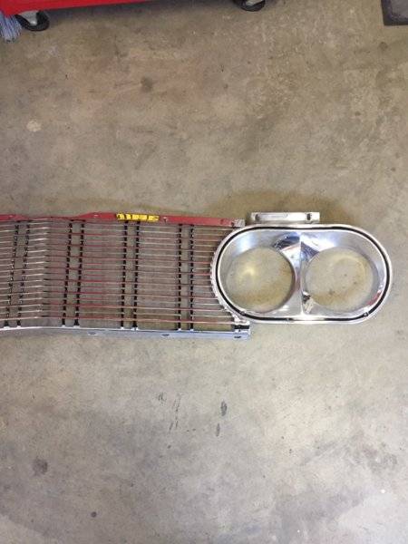

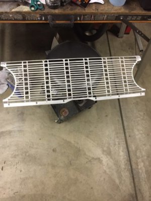

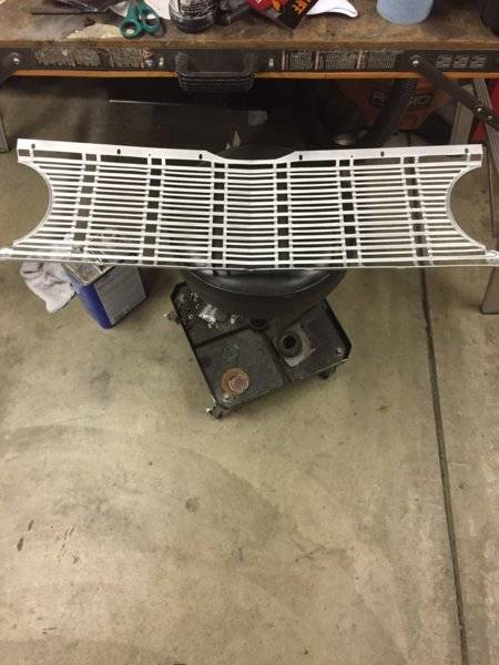

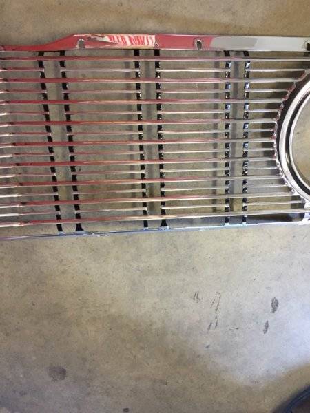

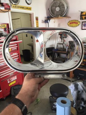

Depends on the look you are wanting.I had my grille and headlight bezels for my 63 plymouth straightened and the dings removed,then poilished,,,NO dip.I have alot of aluminum to polish but with the right tools it makes like good for the old guy.Speak with 5.7 HEMI here on the board.My nose never looked this good and his price was more than fair!!

5.7 media blasted the the old ana-dip off,hand sanded and then polished.Then he painted the bezel and grille spots like oem.You can see on pictures above. It was a pleasure to deal with Zack.

If you just wanted them fixed and polished I can do that for ya and you could then send them out for anodizing and painting. I sure as hell don’t charge an arm/leg, but I also don’t have the equipment to re-anodize.
Personally I wouldn't redip and leave it polished.After Zack get done with it mainteinance is easy peasy!UNless your going for OE gold I like the bling:thumbsup:
