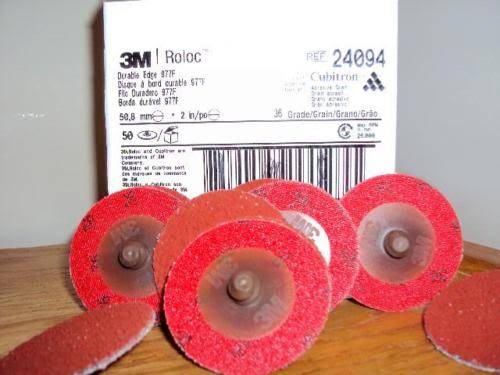

What's a roloc?
Here's a pic of some 2'' Roloc disc's. You probably recognize them. "Roloc" is a product line as 66' B-Body identified and is pretty much a slang term like "Kleenex" or "Cresent Wrench"..
They snap/screw in? Interesting.
