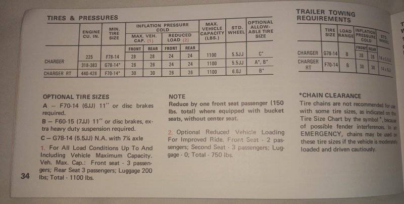

Hi there, I'm writing from New Zealand. Recently I imported a 1970 Charger R/T 4sp manual. As part of the local registration process, there are certain documents I need to provide. I've been asked to supply a GVM Certificate. Anyone out there have any documentation to support or provide evidence as to what the Gross Vehicle Mass (what the manufacturer defines as the maximum weight it can carry)?

That should be listed in the owner's manual if you have one, or in the 1970 FSM.

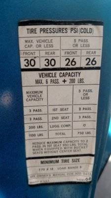

Door jamb:
